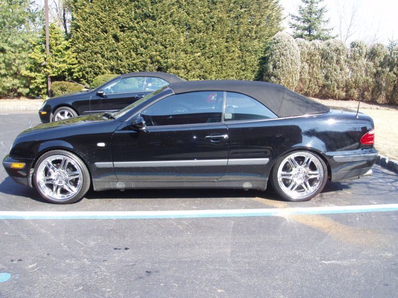

No i think its bull****. I just installed H and R springs from a clk430 coupe on my 320 cab and here is the result. The springs were the exact same, but I have learned that the rear springs are a higher spring rate in the cab, since theres 600 lbs of extra weight in the back. This made my rear a little low but I like the look of it!
The swaybars I think are the exact same. My freinds CLK was up on the lift, (also a 320) and the supsension looked identical.

Mar 30, 2005 | 01:50 AM
Quote: No i think its bull****. I just installed H and R springs from a clk430 coupe on my 320 cab and here is the result. The springs were the exact same, but I have learned that the rear springs are a higher spring rate in the cab, since theres 600 lbs of extra weight in the back. This made my rear a little low but I like the look of it!
looks good. When i called brabus and eibach they said they think the cabrios sway bars connect different then the coupe? i am still not sure?
