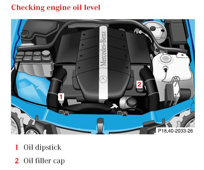

Secondly, It says that the oil needs to be sucked out of the dipstick. I always check my oil from the computer and tried to look for a dipstick yesterday and could not find one anywhere under the hood.
Any help would be greatly appreciated. I am new so excuse the stupid questions. Thanks

I don't know what the "official" procedure is, but I decided to try one of the vacuums myself. I'm perfectly capable of draining the oil from the pan and maintain all my cars myself, have reuilt motors, etc. but I can honestly say that this little device is pretty freaking clever. I got a Motive Products Power Extractor (from Auto Parts World I think) and it kicks ***. It's not like I mind getting dirty, but I've never had less trouble performing an oil change. Pump this thing up (actually pump it out I suppose) poke it in the dipstick tube and unclamp it and it starts drawing out the oil. Return in 20 minutes to pump it again and about 15 minutes later it's done. No muss, no fuss as they say.
Another nice thing about this device is I can use it to bleed brake lines too.
I used to scoff at the idea myself, but never again.

MB dealers use a vacuum device to remove oil from cars. For this very reason I bought a Topsider. Being a member of the Motor Press Guild and specializing in technical articles, some may say I know a little about cars.

Hmmm thanks a lot. I guess I should pick one of these devices up. Anyone know where I can get one? Also as I stated earlier, I don't have a dipstick well atleast not one that I can find. Can anyone help me out? I have always just checked my oil from the instrumentation. Thanks
