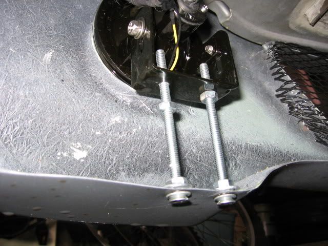

For those who have the front bumper installed. I need some assistance on mounting the foglights. If anyone has pictures or detailed instructions please PM me!!

I wanted the lights to move with the bumper so rather than attach them to the frame I mounted them to the lip of the bumper. You can make adjustment by either tightening or loosening the bolts. I used 1/8" rubber washers with steel backing to absorb some of the stress. There is no deterioration in the fiberglass yet so it seems to be a good idea.
