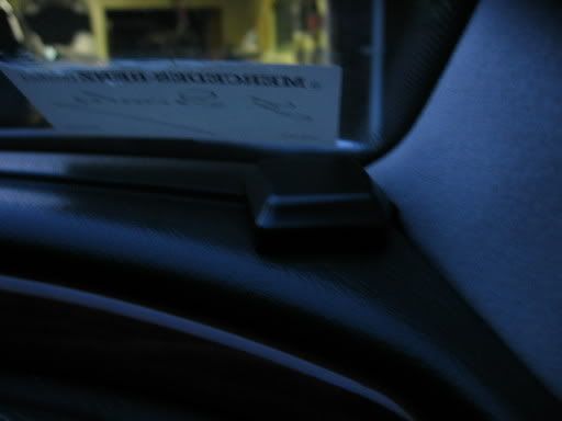

One more Q - do you have to put the end of the antenna on the roof? I'd rather not have to drill anything.

Nope, it sits on the dash:
Tiny too. Here's a comparison:
