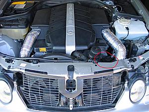

You don't have to remove the air box, just open the cap, and add some mb power steering fluid.

Whoops! My bad...
I didn't realize there was much more clearance on the V8's.
On the V6's there's a lot of stuff covered up by that engine cover. That previous pic certainly makes that clear!
