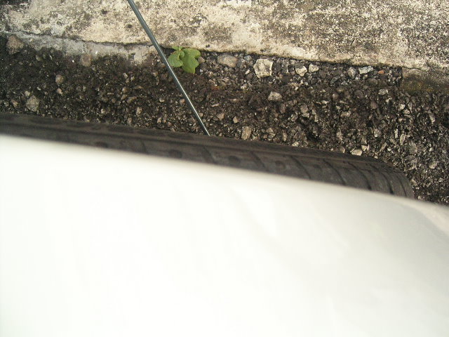

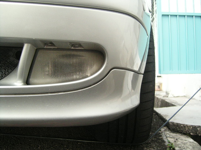

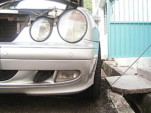

i'm having 225mm on the front axle and as you can see in the pictures, the fender can't cover the wheels already. did you guys made modifications to the fender to fit wider tyres on the front? i see many use 235 here.

Do you have aftermarket rims? If so, what's the offset?

Please give us the full info on rims and tires so we can help you better.
Example: my front rims are 19x8.5

I think you mean you can see the tire if looking straight on at it? Thats because the bumper curves in. A carlsson RS front would help a little. I run 235/35/19 up front on a 19x8.5 rim as well.

225/40/18 conti sp2 on 18x8.5

What offset are u running on the wheels?
looks like to me that u might have the wrong offset, wich it means the rims are not for the car. The correct offset is 35 on our cars for front and rear wheels.

i think that is exactly what he's talking about =)
