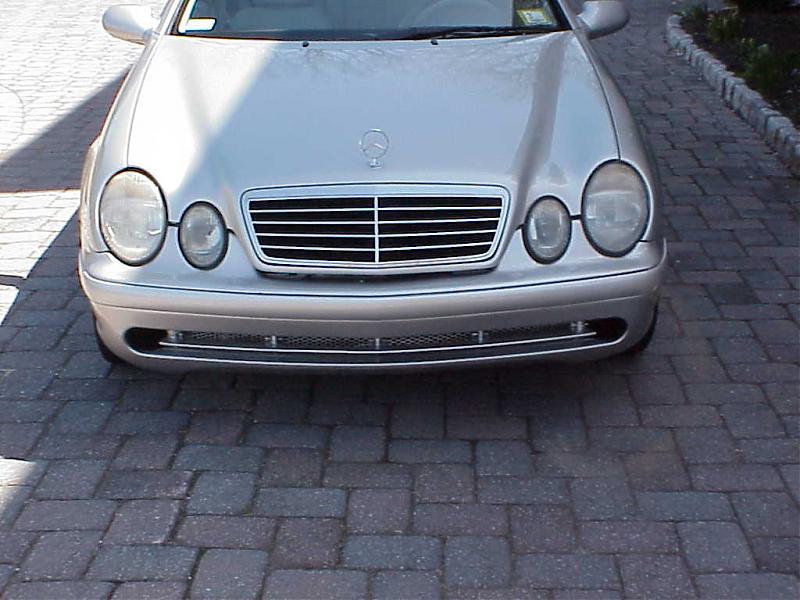

would you please post pics of the bumper you purchased from creative online after install and paint?
thanks in advance

Heres the picture after I just put it on, I had to do some grinding to get it to fit. To attach the impact strip where the sidemarkers go on, u need to dremel out 24 holes to fit the slots of the strip. You will see this after u compare it nexst to a stock bumper. Other than that it looks pretty good IMO. The spoiler also had to be trimmed to fit, and I left the mesh on they gave me. Since the picture i also put in some nice hid style fog lights that look better than the stock amg, and they were 15 bucks at walmart lol.
