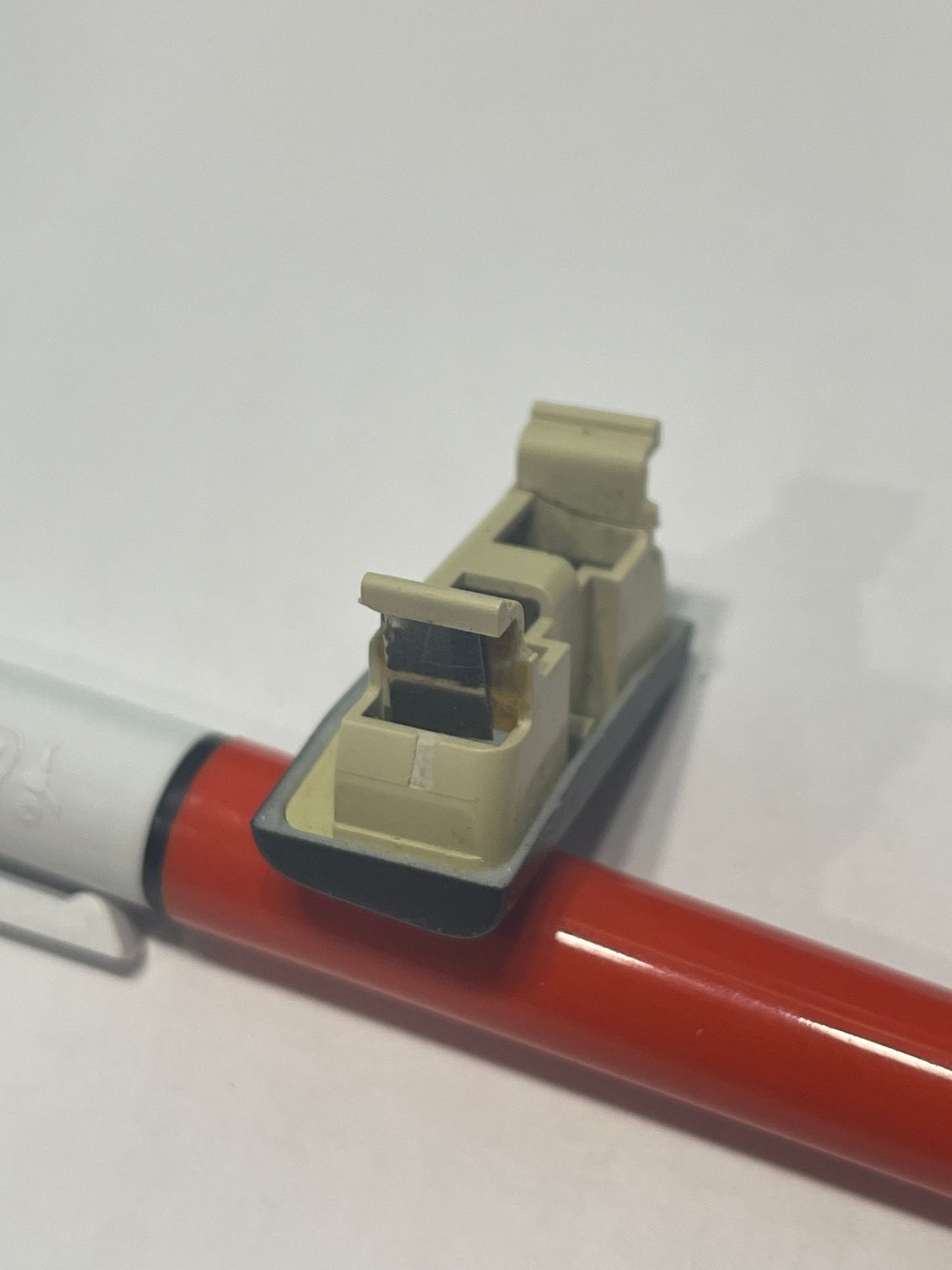

Pics of repaired button
You will see the break in the 2nd pic. Both tabs were broken. I cut 2 small pieces of thin sheet metal for reinforcement across the break. I used contact cement. Solid as a rock. Let dry for 24 to 48 hours is best.
