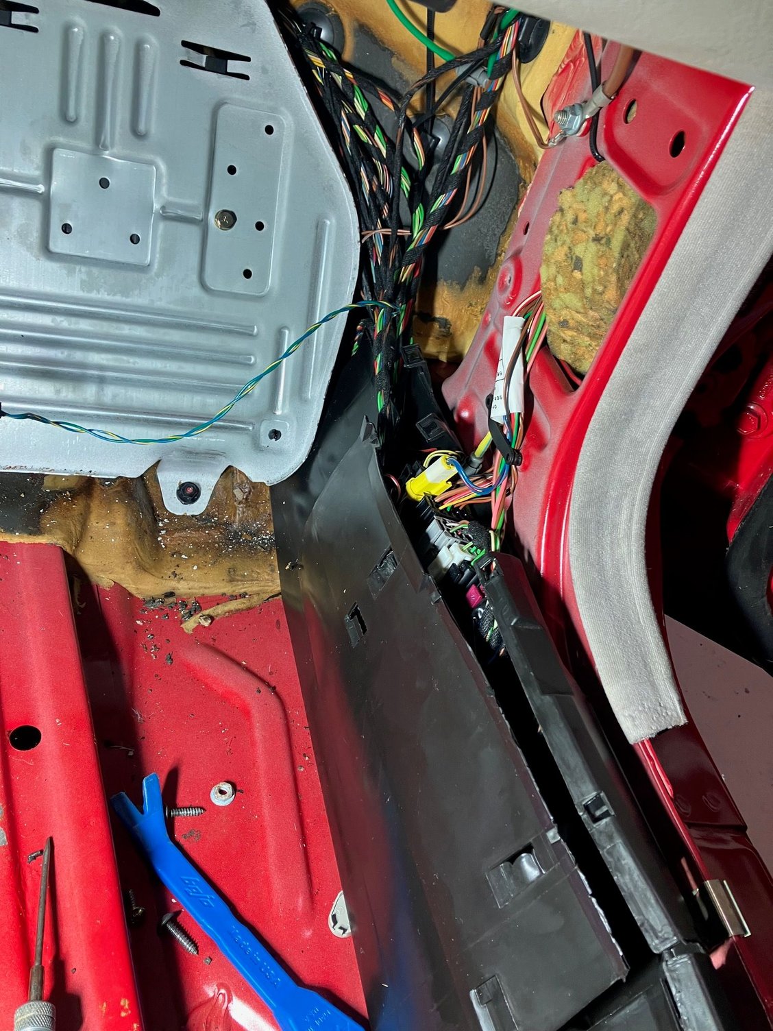

Since I did not hear back from anyone, I tore into the right front kick panel area today. To get to the CAN/BUS connector you must remove the sill panel (3 clips on the weld flange), carpet (just lift out,) under dash hush panel (3 philips screws), and kick panel (one philips screw under a cover in the middle of the panel and 2 clips on the door opening weld flange). Pic 1.

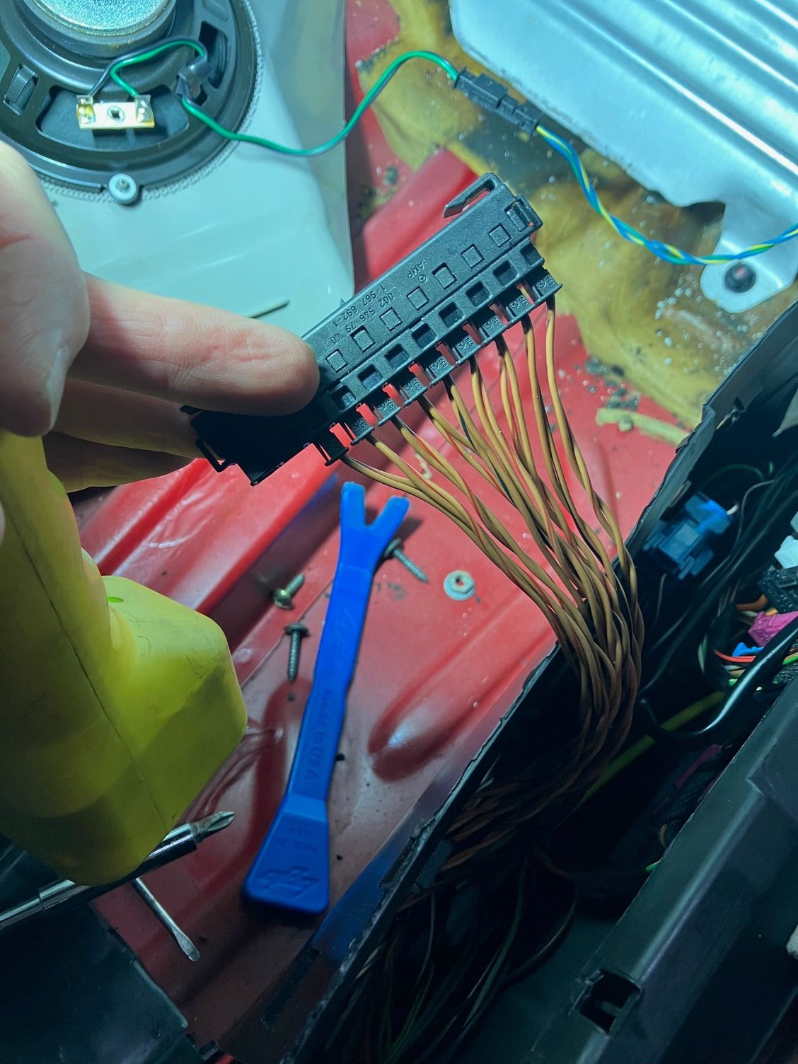

Then you can unclip the wiring bundle cover and expose the mass of wiring through the area (pic 2).

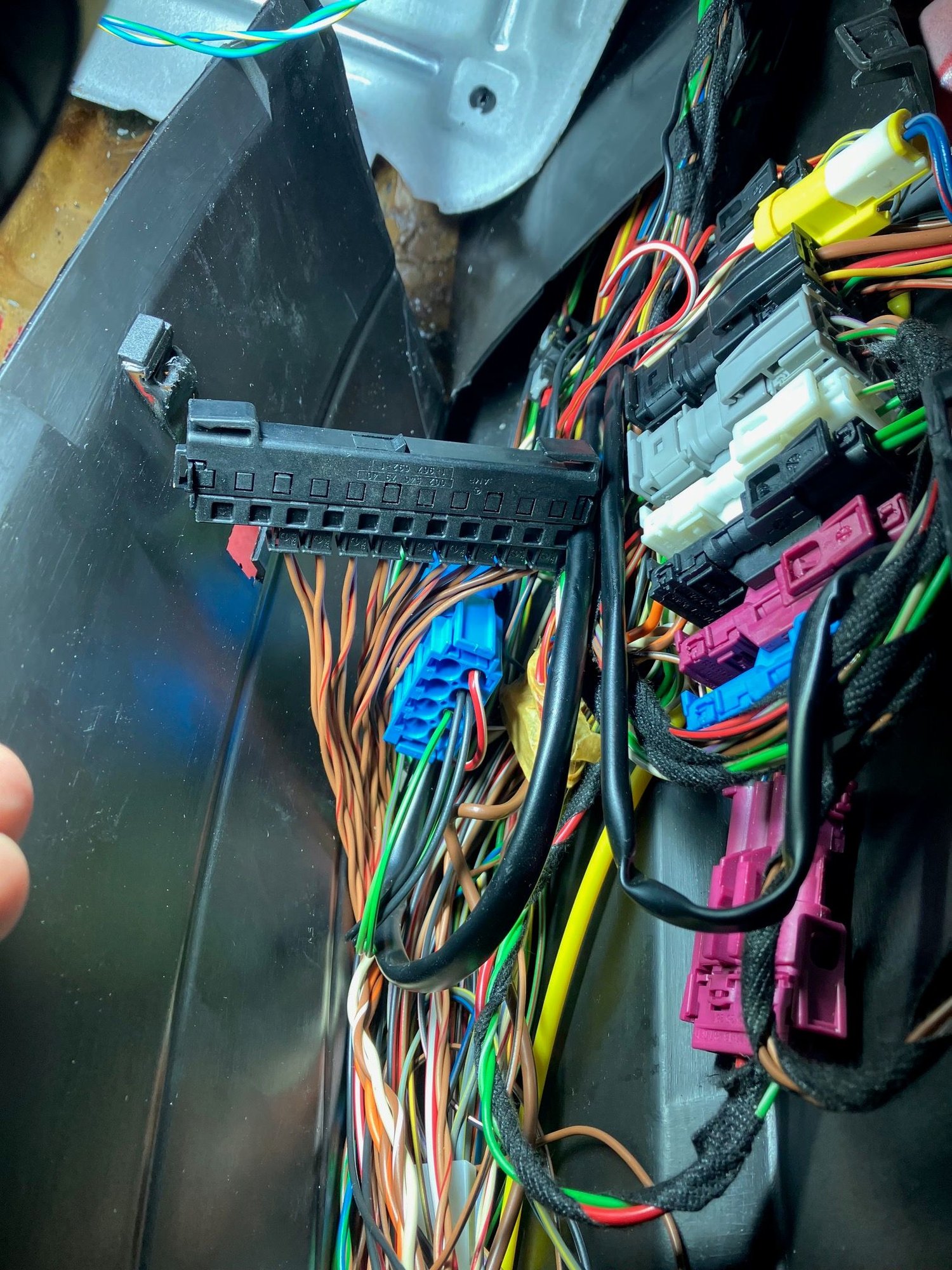

I found the bus connector at the bottom of the front corner (pic 3).

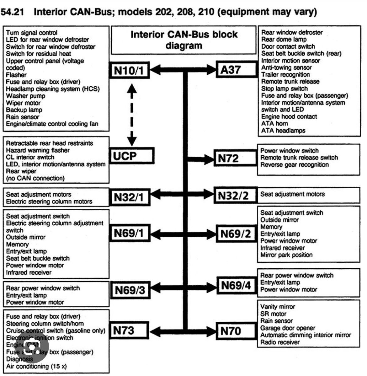

There is enough wire to pull it up and out in the open (pic 4)
I finally got the cover clip off of the connector by lifting the tabs on the ends and prying it sideways. I removed connector one (lower control panel) by pulling it quite hard after not finding a release tab and reset my top. Now we will see if the problem is cured or go on to the next connector. Anyone else who has done this trial and error method would be welcome to comment.
