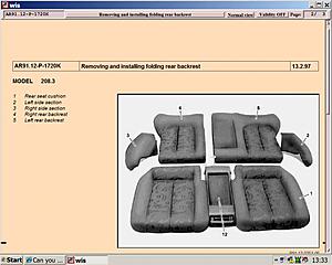

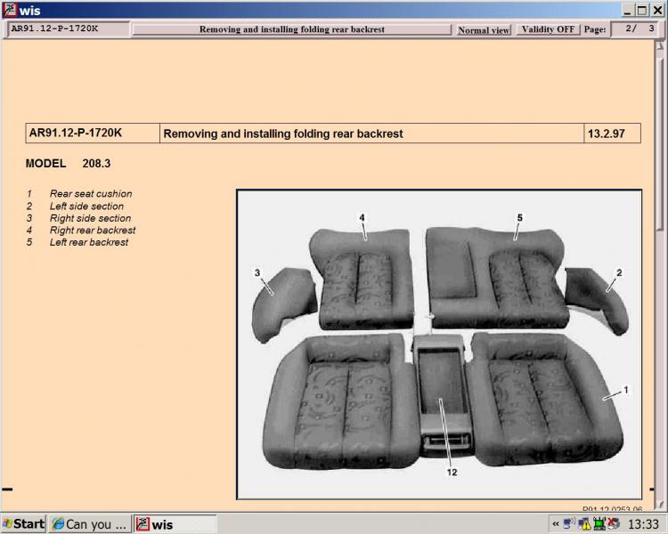

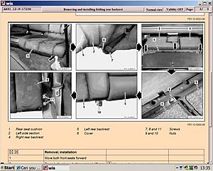

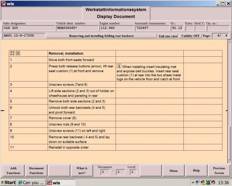

I can't add a photo as I have a W209 but here are some W208 diagrams from my WIS which might help. I'm surprised to read about the release button low down as shown here. On my W209 there are 2 seat release levers accessible only from the trunk.
Attached Thumbnails Can you please help me with a picture?-w208-rearseat-1.jpg   Can you please help me with a picture?-w208-rearseat-2.jpg   Can you please help me with a picture?-w208-rearseat-3.jpg

First of all i have popped the trunk now. I went to a fellow who has a CLK in the next street and located were they were. I reached through and popped the trunk
