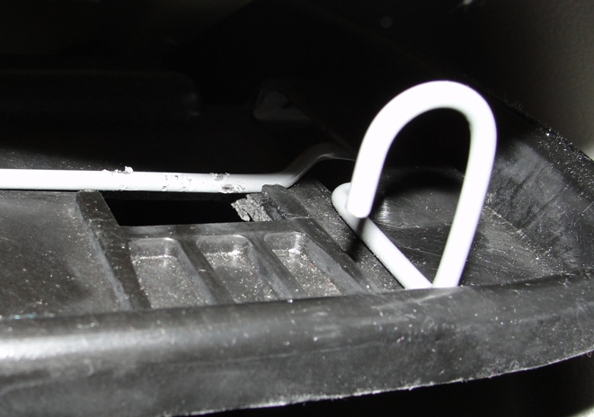

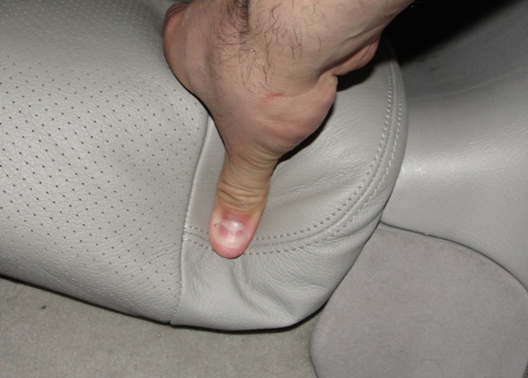

So while I was trying to get pictures and show you exactly what I was talking about above, it dawned on me based on what I was looking at that there is an easier way to remove the effing back seats without taking apart any cushions etc.
Essentially all you need is a little bit of elbow grease and your good. I put together a youtube vid and have attached the link below.
I also attached a picture of whats happening. In the first pick you will see the grey thing which is actually facing up if the seats were flat and the cushion is on. You dont feel it because of all the cushion/foam on the seat. Essentially all you need to do is push on the outer side of the cushion to push back that lever thing and it will release the lever which is holding the seat cushion in place. First you push the cushion in and then you lift it up and it should come up relatively easily.
I put soo much effort and time into just yanking out the leather from the seat itself and then just replacing later, and finally this. An EPIPHANY.
Hope this helps.
