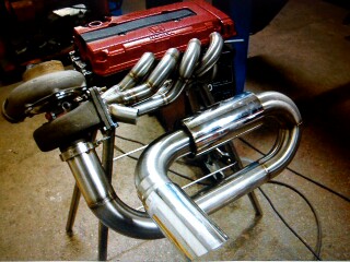

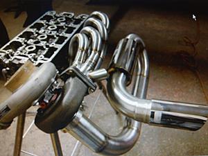

The exhaust shop who are building me a complete system say it will be better than Kleemanns and be made from aircraft grade steel with mandrel bends and tig welding.
Here's pictures of headers they made for another car.

Very nice, and nice wrok done from them as well, that beast looks like a honda H22A prelude motor with custom turbo, i'm assuming it's gonna go into a lotus since thats the engine they used to use in the loytuses.

They didn't say which car it was for, I was just stunned by the workmanship!
