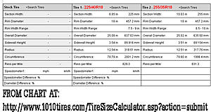

My cruise control will disengage after a while on the highway.
Never had this problem before. I try to cruise at Approx. 77 MPH.
Here are my tire/wheel sizes.
Front: 225/40R18 Kumho Ecsta ASX, Revs. per mile: 829.3
Mounted April, 2010 at 104,000 miles.
Rear: 255/35R18 Kumho Ecsta ASX, Revs. per mile: 831.3
Mounted Sept. 2010 at 110,911 miles.
Could this be causing my cruise control to deactivate ?
If not, then what is a fix to keep the cruise control from deactivating.
When it deactivates, it will not re-engage, unless I pull off the road, shut down, then restart the car.
Thanks
PS. Used a chart on the net to calculate revolutions per mile. See attachment.

According to Kumho, the revs per mile rating on their Ecsta ASX KU21 in a 225/40-18 is 828, and the 255/35-18 is 831. This is the webpage for the specs on their Ecsta ASX KU21 You were REALLY close! Unfortunately, it's not the tires.
I would guess the problem is one of the wheel speed sensors is flakey. To calculate speed, the instrument cluster looks at all four wheel speed sensors. If one sensor supplies a number that’s far enough off from the other three, the speedo uses the left front sensor and the cruise is disengaged.
Try dumping the codes. HOPEFULLY you get a 'this specific sensor is bad' code.
