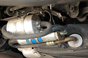

Quote: whats an easy way of getting to it as i am sure my fuel pump is in my tank.
The pump isn't in the tank. It's next to the filter and talkes about 10 minutes to unbolt and check (I work slow, so some may say 5 minutes). Photo #1 shows a socket screwdriver being used to remove the plastic cover. Photo #2 shows the filter and pump after the plastic cover has been removed. Note the blue insulator. If yours is ripped up / deteriorated / trashed, that could cause the pump to make noise. So could the clamp if it's not tight.

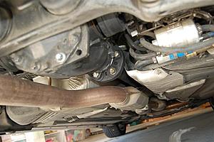

As long as you're down there, you may want to check the flex discs. Photo #3 shows the rear flex disc (to the left of the fuel filter and pump / above the exhaust). There is a rear disc and a front disc. When they wear out, they can make noise. Those are about $100 per disc.
humming noise from rear when letting go of gas 2000 clk430-rentawreck1.jpg   humming noise from rear when letting go of gas 2000 clk430-rentawreck2.jpg   humming noise from rear when letting go of gas 2000 clk430-rentawreck3.jpg
