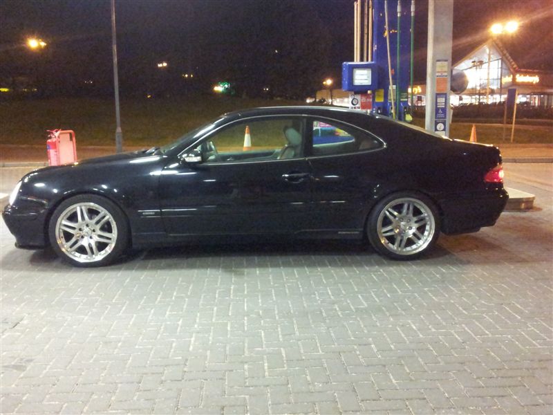

Well Winter is finally away and I have cleaned the car for the first time since Nov 2011 ready for a pamper.
Changed a worn ball joint in the front, polished my summer wheels in the garage and got fresh new tires for them...mmmmm. I bought 20mm spacers for the rear going from 15mm and then put those 15mm ones on the front after a little re-bore at work that was needed.
Happy days the car feels so good to drive !
PS has anyone changed the side light inner headlight bulb (Tiny 5W bulb I think) to something the same brightness as the main beam, so it doesnt look yellow? It should be a simple mod to change the holder etc. let me know what bulb you used.

Do you work at a machine shop? How did you get the rear spacers to fit over the front hub, did you have them re-machined to fit? I have 15mm all the way around, wouldnt mind going another 5mm in the rear. 15 is great on the front, for me.

Im an engineer by trade and I have access to loads of machines at work. I got an apprentice to machine out the inner bore size of the spacer. Mercedes is 66.6m but the fotn hub stick out a little longer so you need to machine out the inner lip on the wheel spacer to get it to fit flush on the wheel hub.
I now have 15mm spacers on the front with 8.5J wheels and 20mm spacers on the rear with 9.5J wheels, no rubing. !
