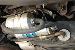

If the insulator isn't there, it should be. Being bright blue, it's kind of hard to miss.

there is no blue anywhere under there! I bought a fuel filter now I just need a decent day to finish it.

That may be why you're hearing noise. On my car, its purpose appears to be as an insulator. You can probably make your own with sheet rubber.
