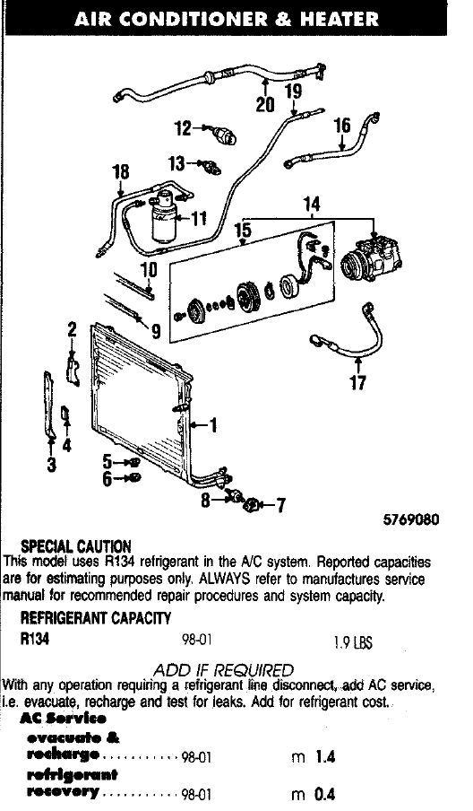

Hi all,
I'm looking for the part number for the hose that goes between the A/C condenser and the drier. I've found the part for sale on this website:
http://www.huskerparts.com/parts/199...w=1&searchtext=
but I haven't been able to find the actual part number.
Thanks in advance!

See attached diagram and corresponding parts lists.

Around 10 years ago, I found a full copy of the W208 parts manual online.
Since the document included illustrations of all the various subsystems, identified the individual components, part numbers, how they went together, I saved a .pfd copy on a flash drive.
I used Windows 'Snipping' tool to extract and post the above .jpg images, from the full document.

I just want to point out that the part number on the list posted (202 830 49 15) is not correct for the OPs car. According to OPs user data, their car is a 1999 CLK430. 202 830 49 15 is only for the CLK320. The V8 cars use a different hose from the condenser to the receiver / drier.
The part number for the hose for the V8 cars is 202 830 50 15. This part is for CLK430 (1999 and 2000 model years) and CLK55 2001 model year coupe and 2002 model year cabrio).
We have both hoses available on our site. You can get to them by clicking on their respective part numbers below.
202 830 49 15 (CLK320 - 1998-2000)
202 830 50 15 (CLK430 1999-2000 and CLK55 2001 Coupe and 2002 Cabrio)
If there is anything else I can help out with, please feel free to post or send a PM!
