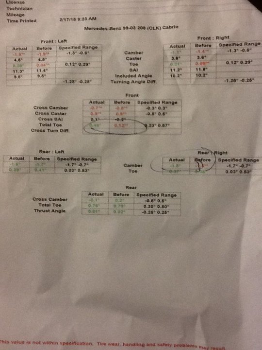

Just got my alignment, but I still have a nasty pull to the right. What do you guys think?

Front toe is the only adjustable part of the suspension. The K-MAC kits are the only way I have found to actually give the adjustability to do a proper alignment. Even then you need to find a good alignment shop that will follow through and set it up correctly.

there are a lot of great alignment shops that I would rather go to before going to the dealer. They setup the car the way I like it based on my driver, not what MB siad 15 years ago. with that being said they also do my mom cars to factory spec. Find a good shop will save you at least $60.
