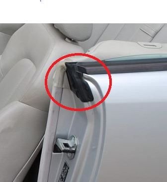

Sorry don't have picture of the actual car since its pissing rain in Vancouver at the moment, so i am using a photo from online.
The photo below shows circled in red which part # i need.
Any insight on how to remove/replace it would be appreciated as well.

But the part i circled in red also needs to be replaced.
The quarter window seal is supposed to be partially covered by the part i need.
The one currently installed is broken so when i close the drivers side window all the way down its fine, but when i put the window back up, it snags on the quarter window seal.

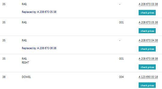

If you can identify the item number from the diagram, I'll be happy to send you the part number.

I think i just figured out from your diagram what i need.
I may have to remove mine to confirm it its the same part.
I believe its part 2086700538.
Looking online its even more expensive than the quarter window seal

Just checked my car since it stopped raining and took a picture of the damaged part.
I pretty much confirmed without removing it, that i do need part 2086700538.
Either that or do some DIY job to cover it with something so my drivers side front window doesn't catch it when i put the window all the way down.

Yes. looks like you need items 35 and 38.
