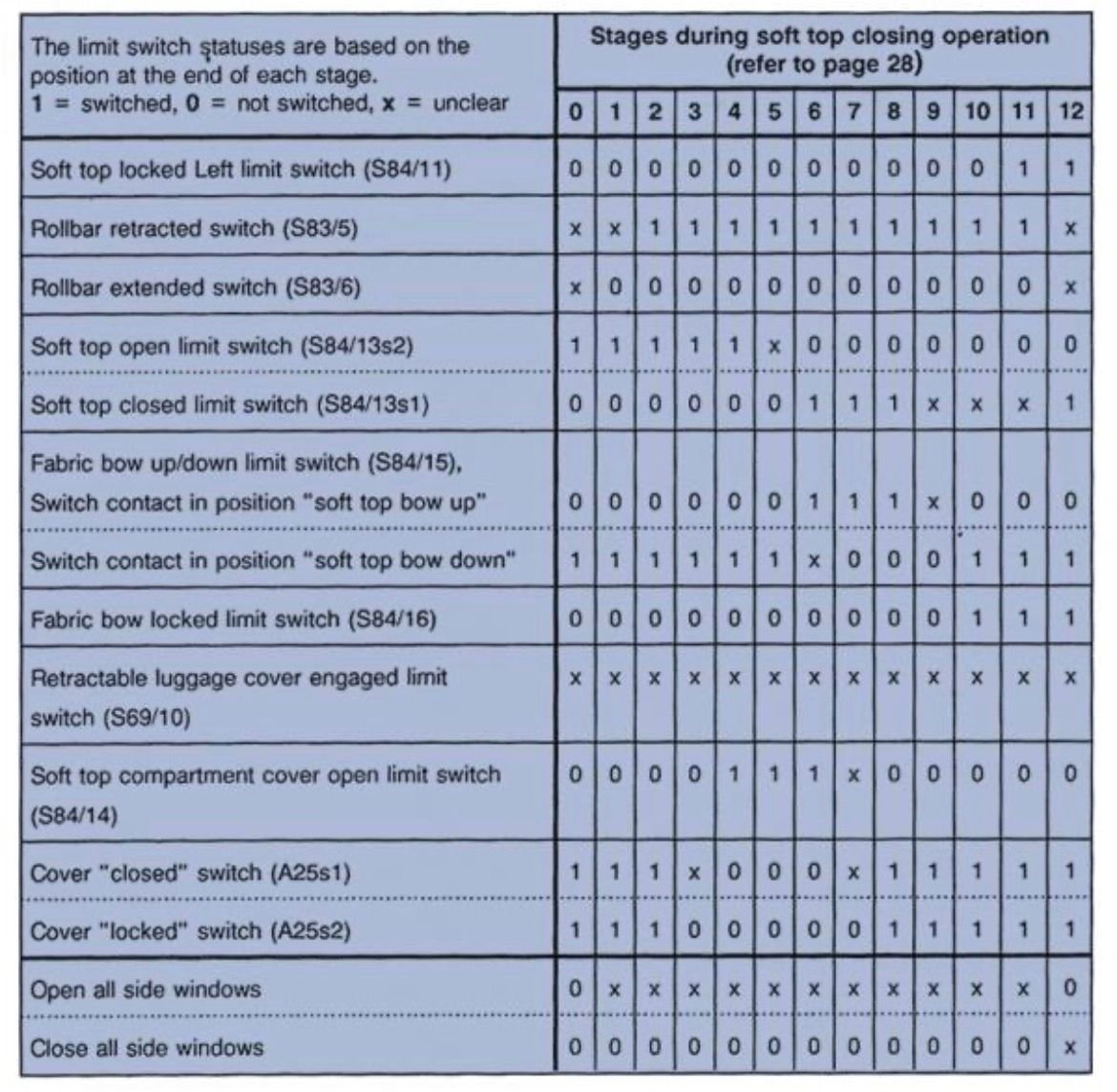

Update. Today I went through all 9 connections to the CanBus connector bar. I disconnected one, then reset the top computer and tested operation. Then I reconnected all and disconnected number two, etc, through all 9. I did not find that any of the modules connected at this connector were responsible for disabling the top computer. Maybe there is a better recommended procedure someone has for this process?

That is good to validate the CANBUS was not the issue. I understand there might be a way to get service codes related to the operational positions/sequence noted in the attached and reposted from here: https://mbworld.org/forums/clk-class...-failures.html
