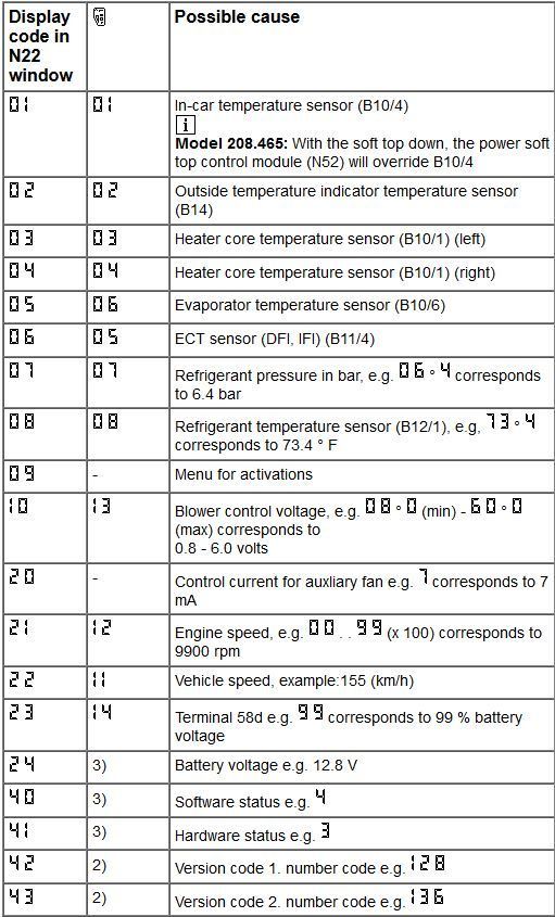

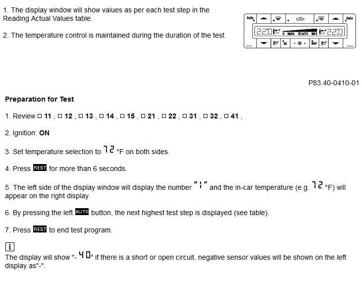

Issues with the W208/A208 HVAC system can easily be identified and repaired, using it's N22 dashboard push button controller, which has complete builtin self test diagnostic capabilities.
There are 3 different diagnostic test, you can run to see your HVAC system's:
-Current actual values, of numerous system parameters
-Any stored diagnostic trouble codes, which must be erased after a faulty component is replaced
-An individual flap test to verify that the vacuum actuated vent flaps are opening and/or closing correctly
As numerous forum posts identified, the blower control voltage regulator has been a ubiquitous problem for the vast number of either no or erratic operation of the blower motor.
While it's an easy DIY repair replacement part repair, there are numerous knock off parts available, that are dead on arrival and/or soon fail, so it's important to only use a genuine MB (OE) or from the company (OEM) that manufactures the part for MB.
The purpose of the voltage regulator is to supply a varying voltage to the motor, where at minimum fan speed the voltage is 0.8 volts and at maximum fan speed 6.0 volts.
You can verify that the part you installed is working properly with a multimeter, where the voltage on regulator's input terminal is at or near the vehicle battery voltage and the voltage on regulator's output terminal is between 0.8 and 6.0 volts.
Alternatively, you can run the diagnostic system value test setup and current system parameter values as described below.
Note: The reading in step 10 will show the your blower control voltage
Lastly, when replacing a faulty voltage regulator, there is no climate control reset necessary.
If the voltage supplied to the blower are within the nominal operating range and blower motor does not operate, it could be worn motor brushes or the motor itself.

So I ran the test as you outlined and the voltage reports as correct in the range specified of 0.8 - 6V. Is it safe to assume then the Blower motor itself is the culprit? I'm not sure if it's worth it to try to acquire the brushes or just purchase the motor outright.
