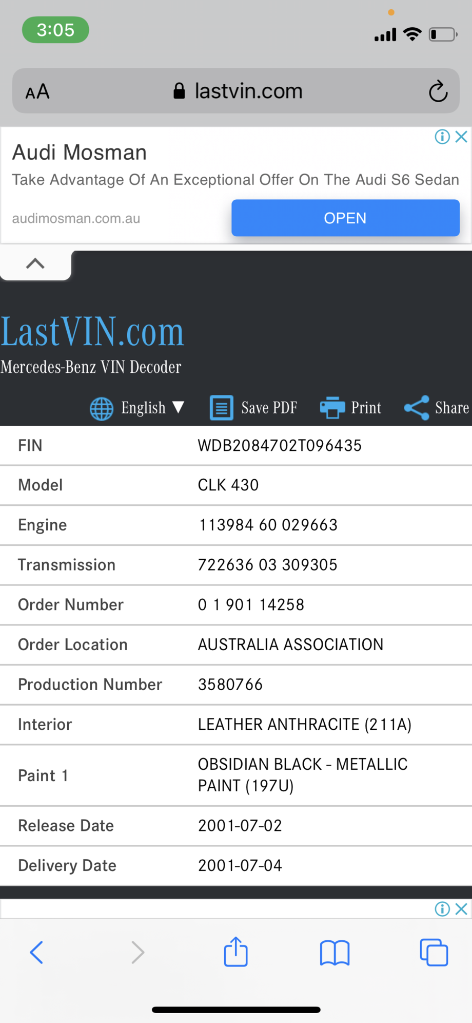

Old Jan 18, 2024 | 08:06 PM
Cassios's Avatar
Joined: Jan 2024
Posts: 7
A208 Clk55 AMG Cabriolet
I do have the data card. It denotes a clk430. But I am referring to your comment about the very few 430 cars that were made with the full AMG setup. I have the factory data card with 55 engine, transmission, suspension and brakes including clk55 badging and amg badging. It came from the factory like that but with the 430 chassis number.
My question is, how do you know a very few of these were made making it the very first clk55 cabriolet? I’m in agreement with you here, I just cant find the anctual info not even through mercedes Benz. Even though my car came with the m113984 engine which it still retains from when it was built from the factory, along with the suspension, gearbox and brakes Your help would be appreciated.

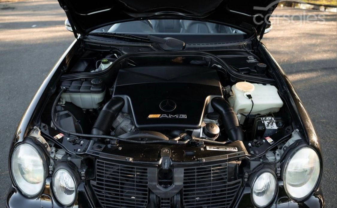

Old Apr 30, 2025 | 01:19 AM
unlukky's Avatar
Joined: Apr 2007
Posts: 737
Likes: 38
From: Fort Worth, TX
2019 CLS450/ 2002 CLK55
What is your VIN and can you upload a picture of the engine?
John

Old Apr 30, 2025 | 06:46 PM
unlukky's Avatar
Joined: Apr 2007
Posts: 737
Likes: 38
It sure does look and smell like a 55 on the data sheet.
I see this:
026 PRODUCTION TEST NEW ENGINES (ECE-CHASSIS WITH USA-).
I don't know what that is.
I wonder if the 430 was switched with 55 simply on the entrance paperwork into country?
John
Old Apr 30, 2025 | 06:48 PM
unlukky's Avatar
Joined: Apr 2007
Posts: 737
Likes: 38
It really might be nothing more than a typo way way back?
