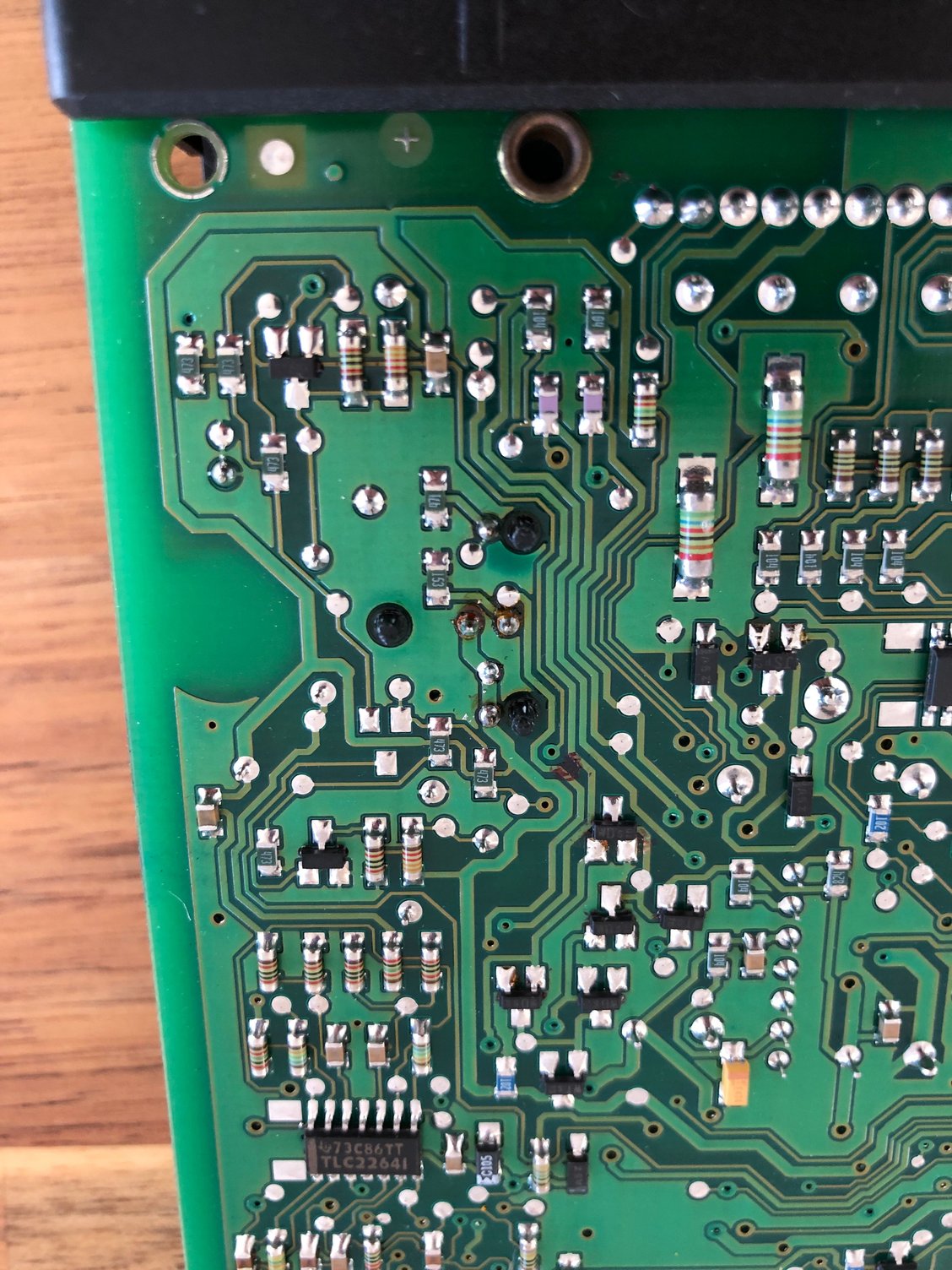

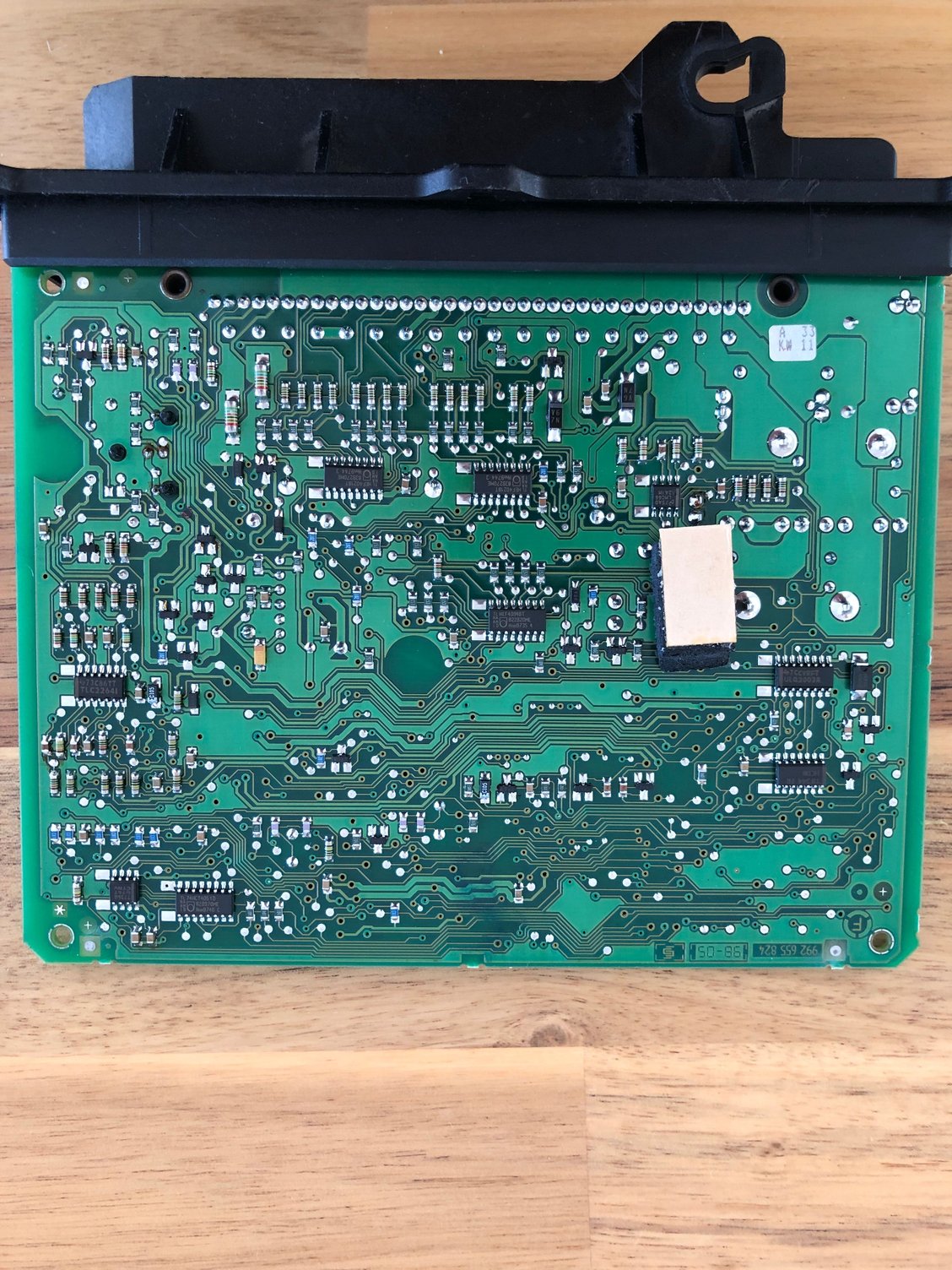

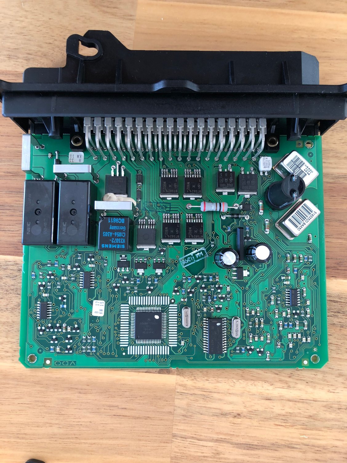

I bought a used one. I opened and checked the faulty one and I believe that there are a couple of connections that seem “burned”. These are the connections of the “gyro” sensor I believe because when I tilt the ecu I hear something like a ball moving inside of it.
