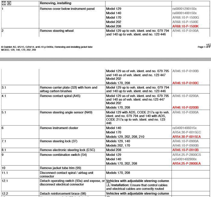

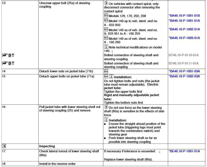

The steering box is attached to the vehicle, by 3 bolts located inside the inner fender, that you'll see when you remove the driver side front wheel.
If the connection to remove the steering box from the column is not accessible, here is the MB WIS to remove the column jacket.
