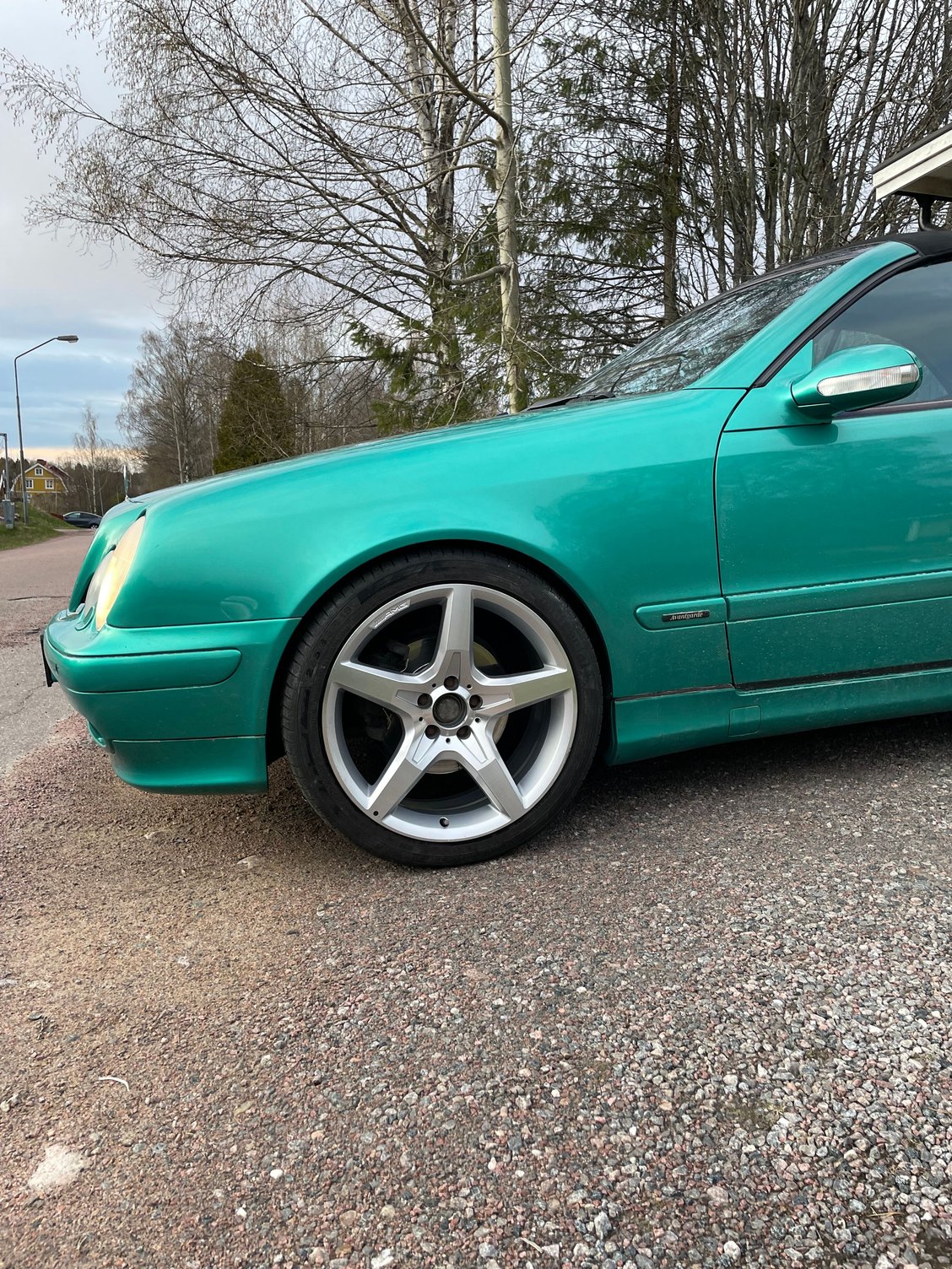

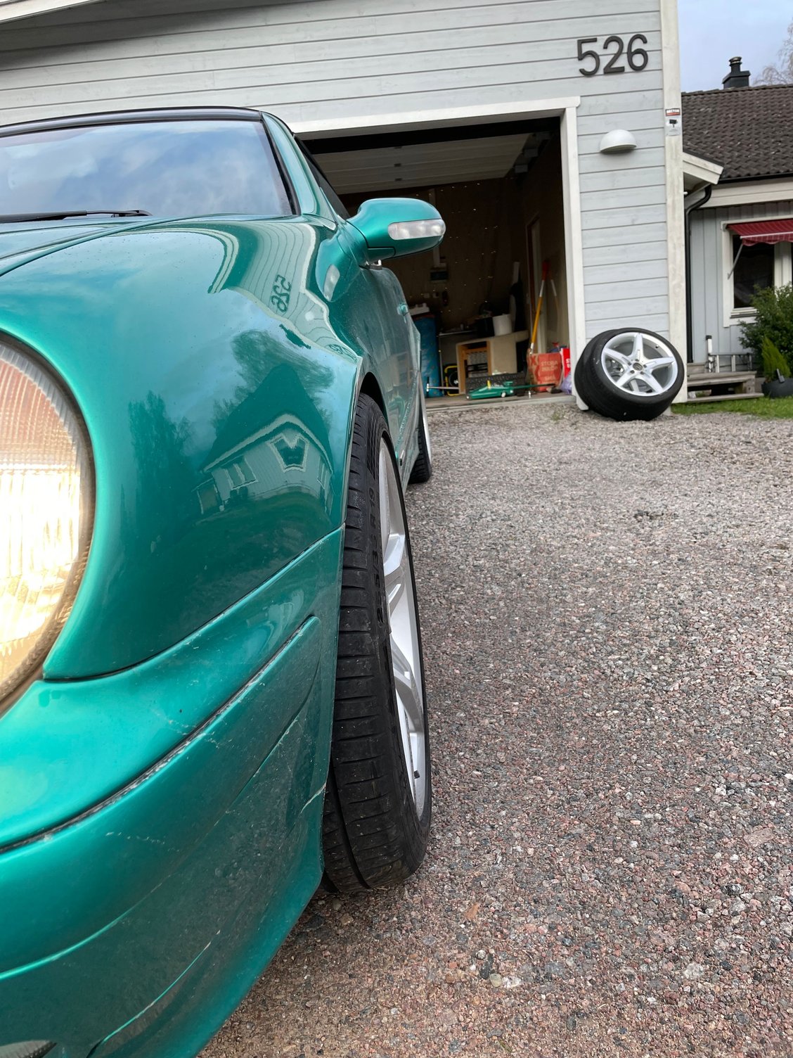

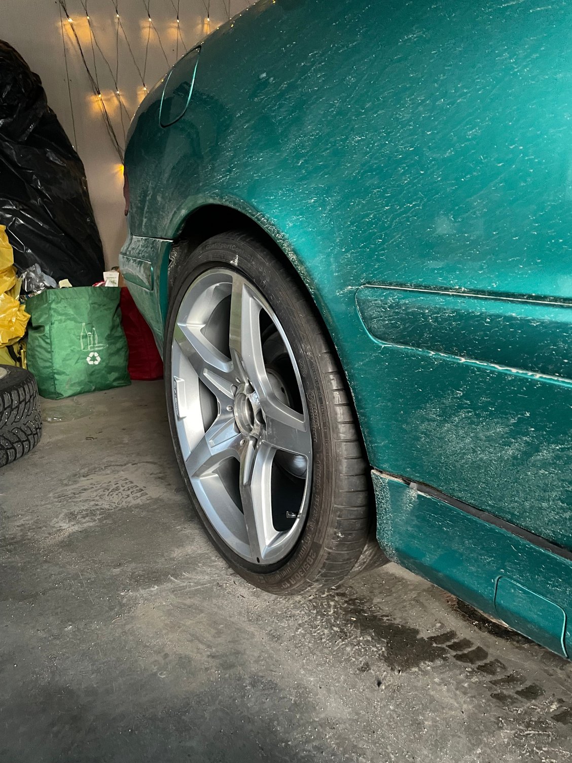

My green CLK is undergoing some updates. New front fenders and new wheels. Wheels from SL 63 AMG (R131). The rims fit exactly as I want it to bee, but I need other dimensions on the tires. I use 5 mm spacers in front and 10 mm in the rear. 235/35 tires should work at the front and 265/30 in the back. The current dimensions is not clearing the fenders in the front. The back tires are lining upp nice but rubbing the inside.
The paint will undergo som serious cleaning as soon as the the wheels are done with the right tires.
8,5 x19, 255/30-19
5mm spacer but need 235/30 tires
9,3/4 x 19, 285/30-19
