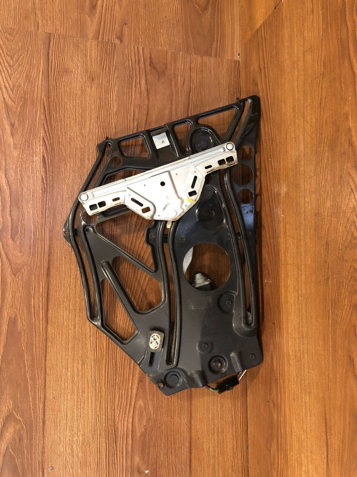

I now have the part, and last night I went on eBay and found a listing for a right rear quarter window (w208) that has pictures that help. You can see the bracket in the pictures and it gives me an idea of what I'm going to be looking to do. I'll be interested to find if the actual bracket has failed at the plastic joint, or if somehow the adjustment has just moved over time. Seems it should be one or the other. In any case, I have the new stop bracket and it was only $15, so not a great waste if I don't need a new one.
Yellow line shows bolt holding the stop. It's in a slot so it looks to be "adjustable".
The small aluminum square is at the top and is the "stop" bracket. If you enlarge a bit you can see that the tip of it is black plastic.
