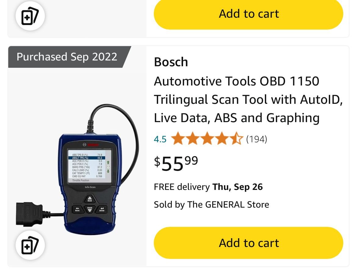

#1 - buy a scanner for ~$50 like the Bosch OBD 1150 and let us know what codes are present
