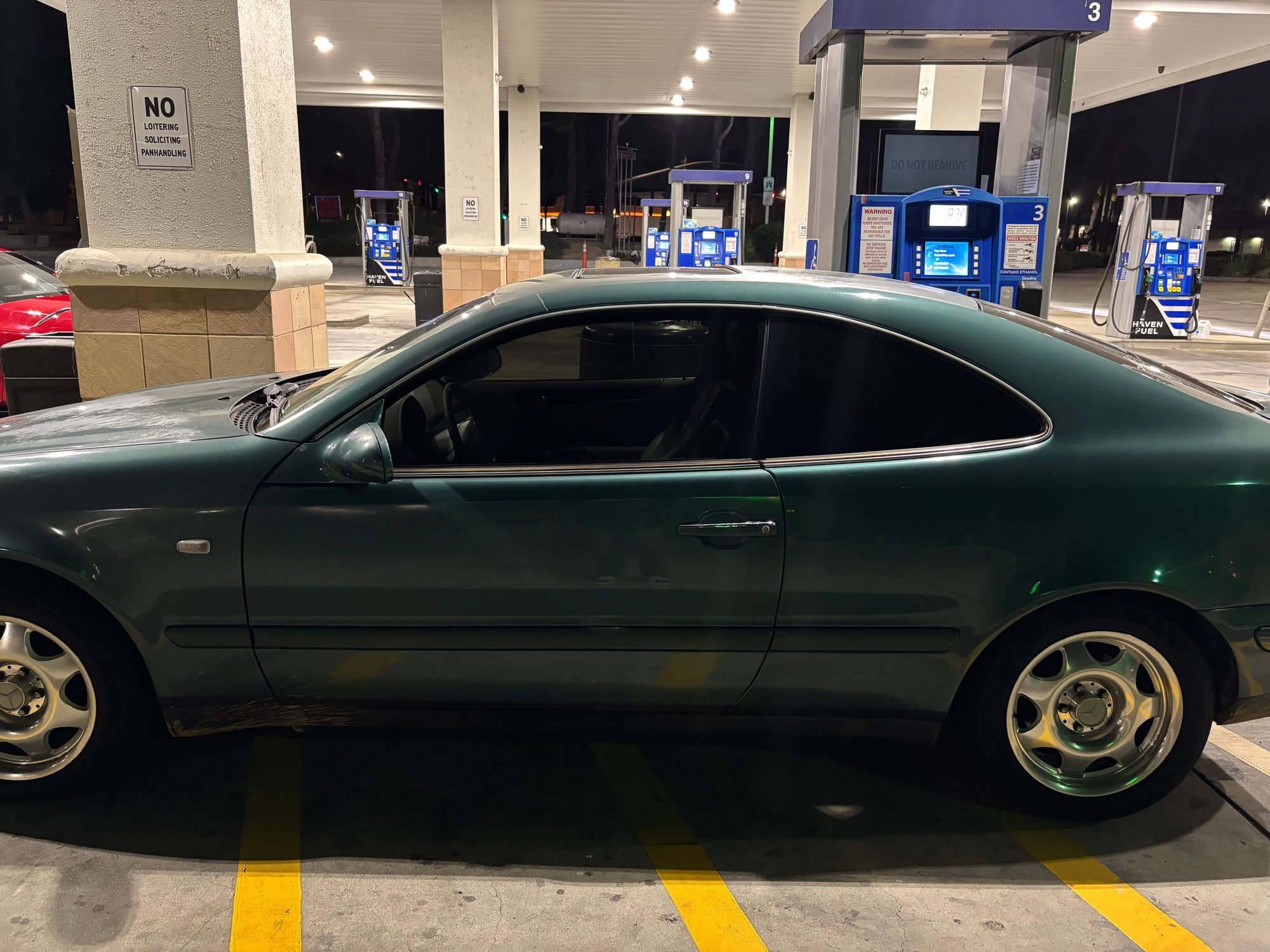

I just bought a 1999 CLK320 on OfferUp. I want to service it, help!
Old Sep 5, 2025 | 01:28 AM
AP4646's Avatar
Joined: Sep 2025
1999 Mercedes CLK 320
I have no idea what to do other than an oil change and oil filter. It has 235k miles, I want to make it last till 300k hopefully. It’s my daily right now, I bought it so I can drive to and from work and the gym. Anybody recommend what I could do to maintenance wise?
