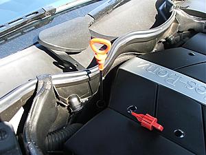

Hers's a pic of the tube with an M-B 'measuring stick' inside during an oil change. The red plastic cap is shown on the engine cover alongside.
Probably best if you get another - the dipstick tube should be plugged to keep muck out.
Thank you for that picture. That is exactly the tube I am talking about. I have been having weird things happening with my transmission recently and this may be why - no cap. And who knows how long it's been off...... Trans getting stuck in a gear when manually shifting, when running at WOT clunking into 2nd gear (sometimes) and just generally off it's normal shifting points.
Sorry to be negative - but that tube is where the engine oil dipstick used to be. That's nothing to do with the transmission oil.
To see where the ATF dipstick is, you have to pop off the plastic engine cover. The cap is normally 'sealed' closed.
