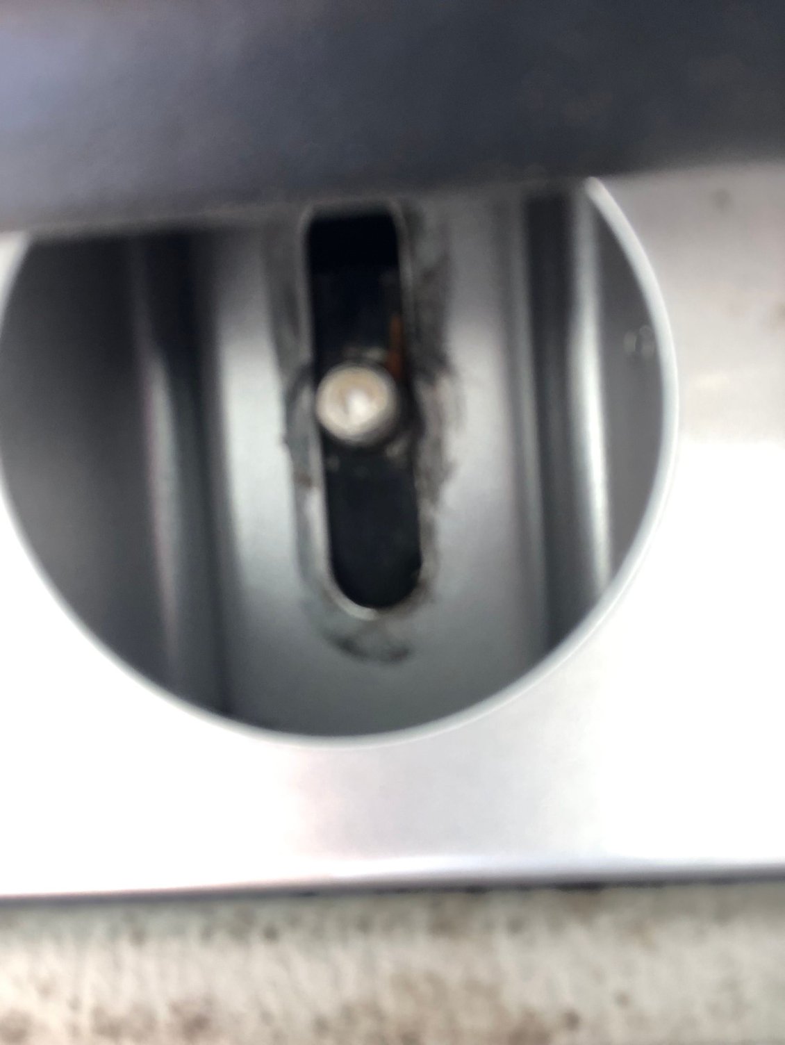

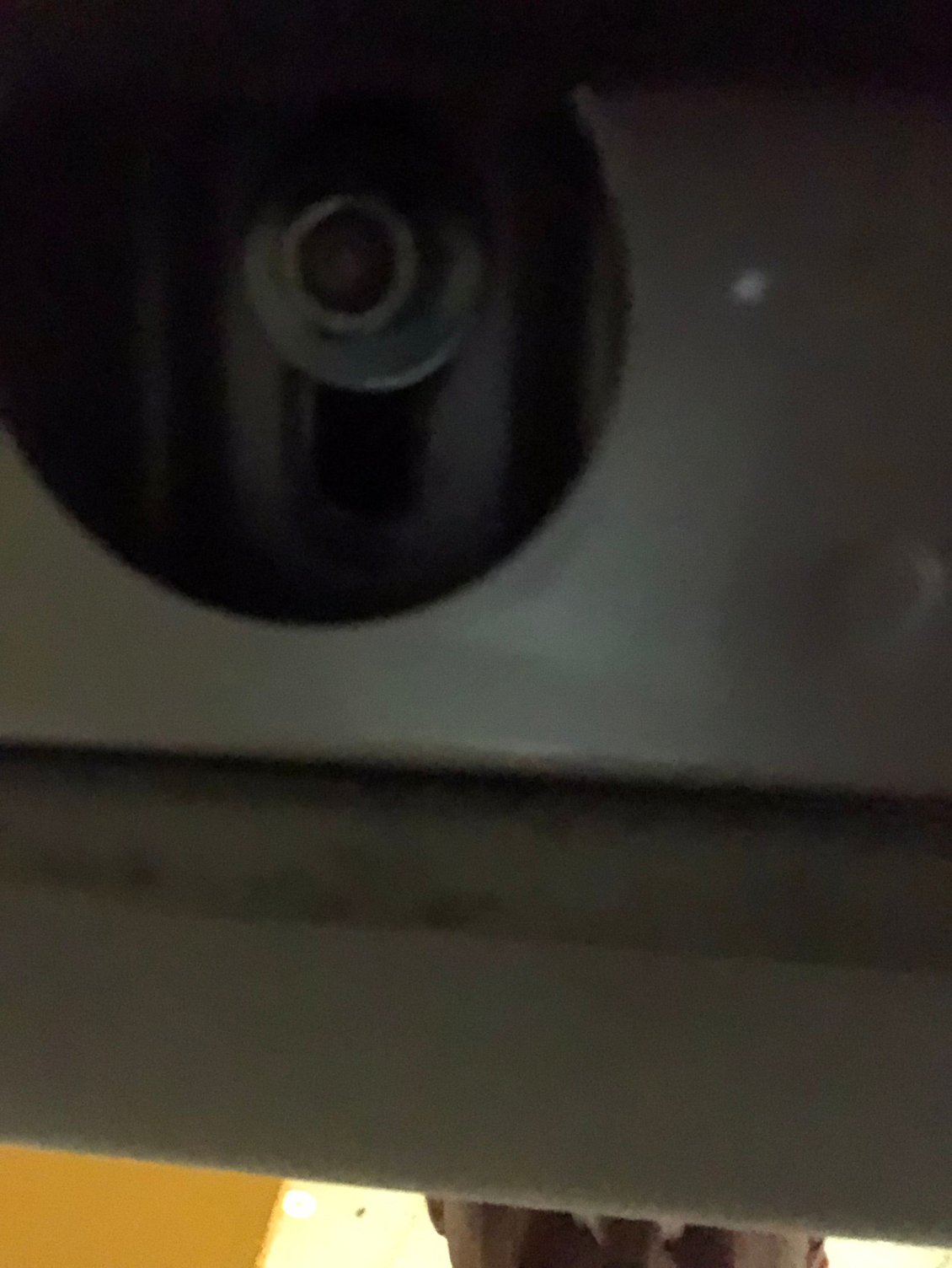

Well, got the right nut, M6. Here is my before and after. I did not have a torque wrench. I cautiously tightened with a socket and breaker bar by hand. It did not seem to have a lot of thread below the bottom of the nut after I was done. I will double check it in a few days. I just used an ordinary washer.
It does seem quieter. Now I am hearing other sounds, some of which were my box of tools in the car.
I have parts coming for the glove box next week which is hanging on by a thread and definitely another source of sounds. Once that is bolted on properly I can see where I stand. I am wondering if I need rear springs even though my shop just said they did all the suspension that needed to be done. Will also have them check motor mounts and transmission mounts again.
