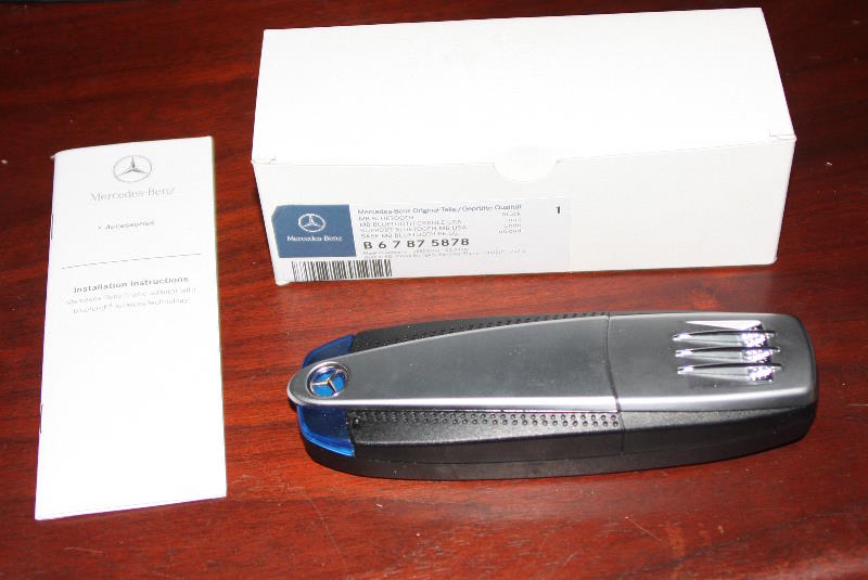

Does your BT look the one in the pic. If so, make sure you put the key into ignition position and then hold the Merc Emblem Button on the BT until it starts from solid blue light to flashing blue lights. Then pair it with your cell phone using the pw 62872 (MBUSA). I hope this would solve it.

Yes I did follow these instructions. The phone recognize the MB System and it looks paired. But my car says NO PHONE.
