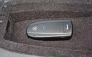

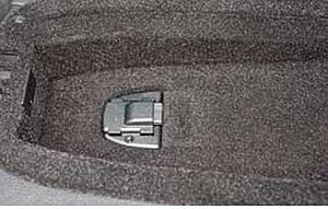

Is your car not wired for the Bluetooth puck under the center console storage lid?
Attached Thumbnails I Want My Aux Plug Back-jpg1.jpg   I Want My Aux Plug Back-jpg2.jpg   I Want My Aux Plug Back-jpg3.jpg
