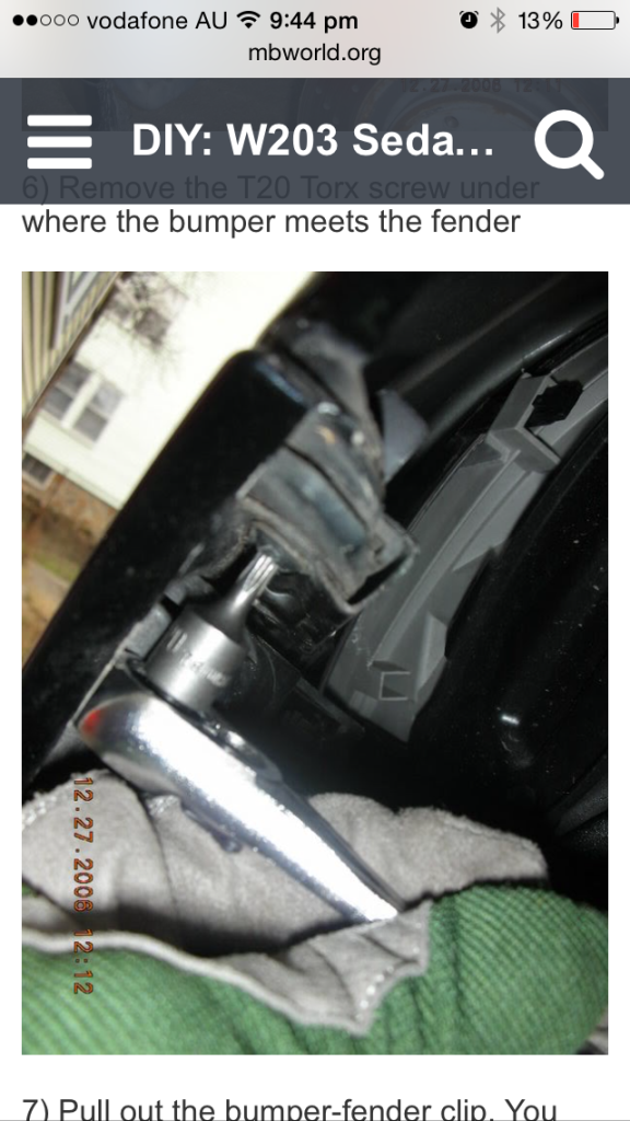

Originally Posted by LordPhoenix
Its the fender, the bumper sits fine.
Its the fender section that tends to life a little upwards/outwards,
I found this...theres a T20 torx screw that holds the bumper to the fender. Remove the front left wheel and the wheel well liner and you'll see exactly what in the photo. Check if the screw is there.
Bodywork Question/Issue-4f96fae3-7223-4d78-91ef-22ced5de4317_zpsewiuiwtr.png
Old Jun 27, 2014 | 08:17 AM
LordPhoenix's Avatar
Joined: Dec 2013
Posts: 102
From: Johannesburg, South Africa
2004 CLK 320 Coupé
Thanks,
I'll check this out when I get home and revert back.
