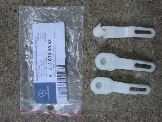

It sounds as though you have a distribution flap jammed, Stepper motor failure or broken stepper motor arm.

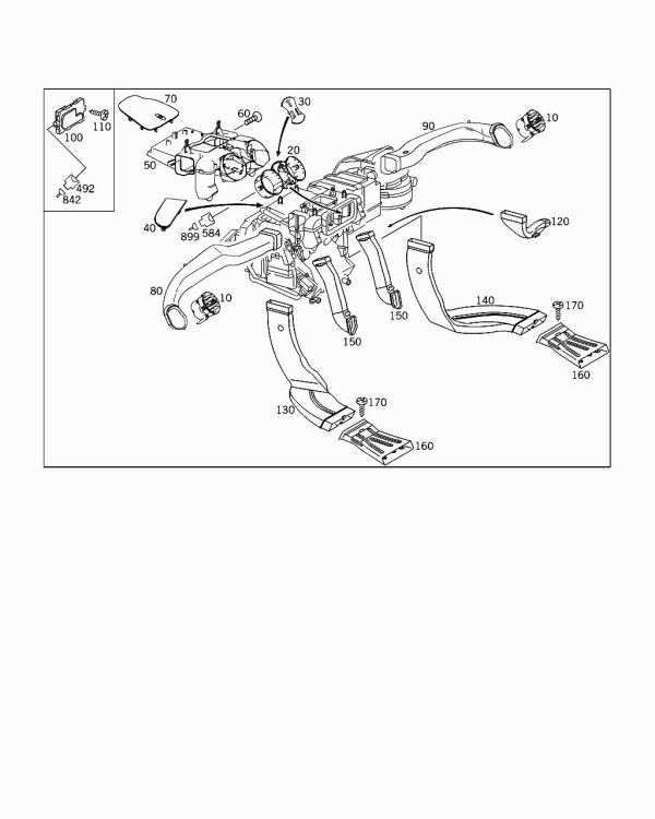

If not successful you need to get the car onto a Star. Quite a bit of the dash has to come out to repair. Far easier to leave to a Tech that strips Benz dashboards daily or it can be a very long DIY job depending on where the fault lies. I would not sell the car for this.
Spares available from RMEuropean etc.
