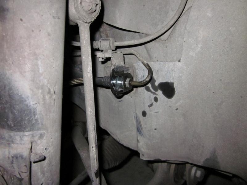

The top join of the new line. The U shaped bracket holds the line into the mount. Trying to undo this quickly to put a bung on the end of the line is not going to happen. Put a rag underneath.

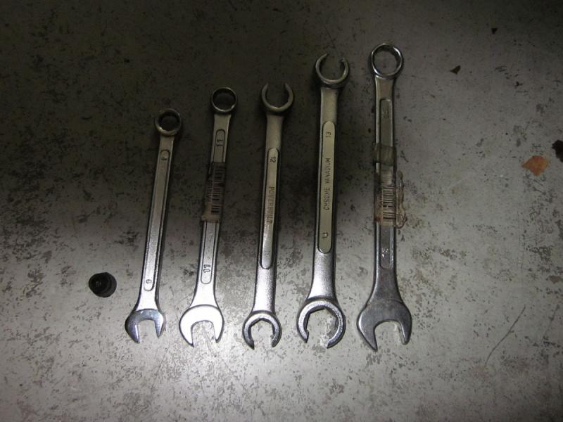

These are the tools you will need. You don't technically need an open end 11mm but it is a lot easier to undo the nuts once you have broken them loose with the 11mm brake spanner. The front bleed valves use 11mm not 9mm as per the rear. There is only one bleed valve per caliper at the front, I think the 6 pot calipers have two bleed valves.

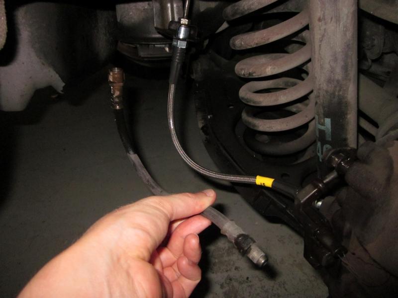

While the rear lines were very easy, the front lines are only easy. They come out horizontally and head down.

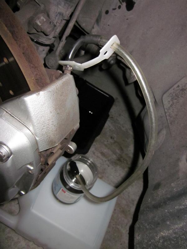

This is my one-man bleed tool. I used it alone for the drivers side since I could see it. I got help to do the passenger side.

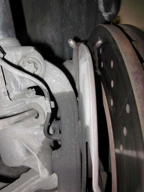

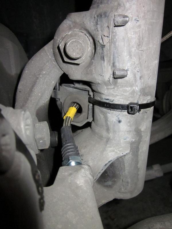

The line is very difficult to screw into the caliper with that rubber bung/mount still there. I was worried I would cross thread it. I highly recommend taking it off. It has two plastic prongs that clip behind a steel mount on the strut. It also has a thick cable tie type thing holding it underneath. Cut the cable tie and gently pry the prongs out. I promise it is worth it (unless you break it of course). Screw the line into the caliper and then push the mount over the line before putting it back and applying a new cable tie.
Any tips for changing the brakelines/bleeding fluid-brakelines11_zps05ee0769.jpg

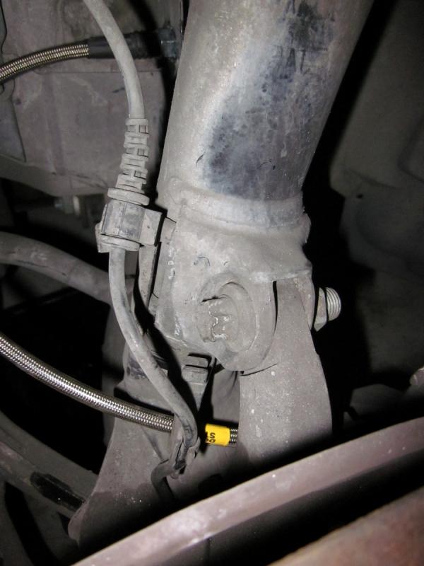

You can see the plastic prongs here where they come out. They push towards the strut to unclip while prying at the other end.
Any tips for changing the brakelines/bleeding fluid-brakelines12_zps9b6ccd89.jpg
Be careful of what I assume are the abs lines when you take the plastic mount off.

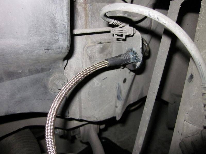

Yes brake fluid continues to drip out until you have the hardline secured 100% inside.
Any tips for changing the brakelines/bleeding fluid-brakelines14_zps4de3d08e.jpg
Done. Just treat brake fluid like a deadly virus, wash your hand constantly so there is no chance of spreading it around. Was it off everything with degreaser and water so prevent paint bubbling and corroding everything in sight.
