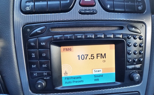

can you take a picture of your headunit? just to make sure we're on the same page. or find a picture on the internet of it and post it here. make sure its the exact same one

Here is the photo of the dash head unit
Okk great!its pretty simple for you! You have what is called command 2.0. I had to retrofit command 2.0 just for aux. just follow this guide i got off the internet.

That is correct! Big difference! But as rodney stated the facelift model which starts by MY2005 runs on the MOST System. Thats why i told you to send a pic of your headunit to make sure. If it looks exactly like that picture that you posted and not like the picture below then its the prefacelift model (D2B system)
You do NOT have the facelift model. This is a MY2004 or earlier.
