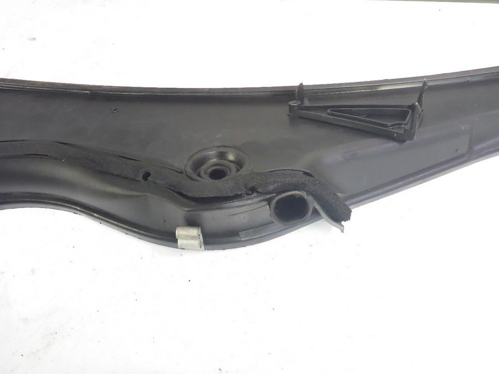

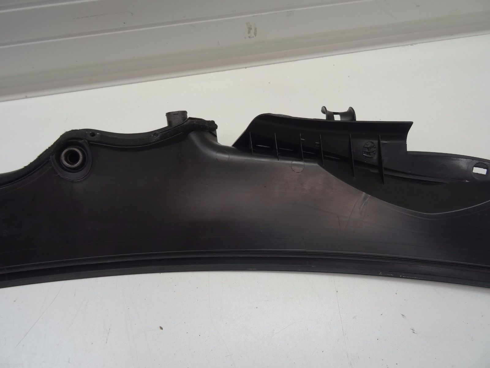

EDIT:
I've found this pic on the web:
Just making sure, you're talking about the little ridge on the top of the part in the picture.
Here is another, it's in the bottom this time.
Oh, and I can confirm that little seal piece that presses against the windshield. Mine has that too.

I checked into this really quick at lunch time, and I might have bad news.
I was trying to look behind the plastic piece, and I didn't see that aluminum channel the plastic lip is supposed to go into.
Could somebody please post an exploded view that shows this part, so I could check into buying one?
But you can actually see that little seal on the plastic part.

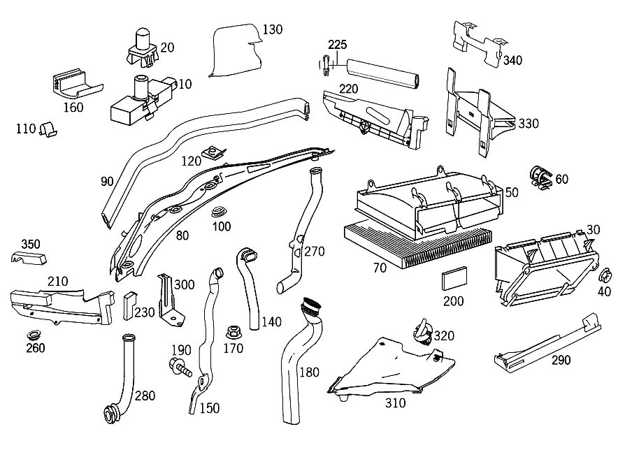

I also wanted to follow up on the drain cleaning issue.
Here is a picture that shows how the water flows down the plastic cowl piece, through the channel and then down the drain tube, in case somebody is having issues locating them. I know I sure did
