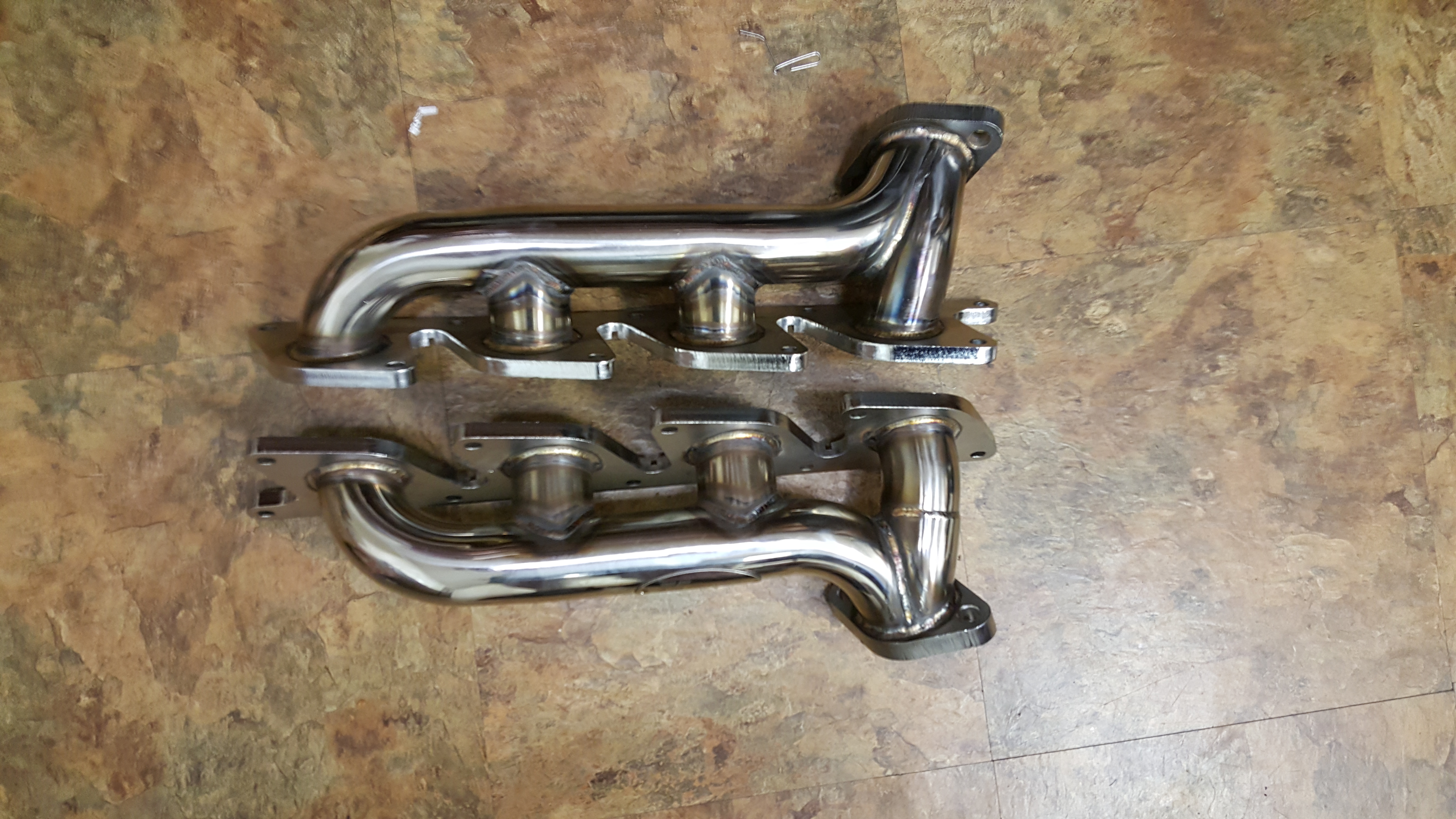

I finally got the headers we had made. I'm hopefully going to try and install this week. So they are shorty headers that bolt to stock down pipes on the 550's

So these are made to mate to the existing cats and exhaust pipes? I am not an expert in exhaust systems, but I thought the whole purpose of headers was to pipe the exhaust out of the engine in a path as straight as possible with no right-angles like a "manifold" has. The ones I have seen are made to keep the pipe gently curved and they end up being so long that either the cats are removed, or moved back in place of the the resonators.
Rudeney, you are correct. There are typically 3 types of headers, Long tubes as you described, mid length and shorty headers.
Long tubes are def the best for performance. With them you will not have cats and need custom exhaust. I do not know of anyone that makes long tubes for the M273. I considered it because that is what i wanted, but i didnt know how many people would want to go cat less sales wise.
Shorty headers like this are made for lots of vehicles, because they do bolt in to the stock exhaust as you stated. Everyone's shorties are different. Being tubular and a little bigger piping they do flow better than stock. But i agree they are not like long tubes.
The only other companies who make headers for the 273 are Renntech and Kleemann. Renntechs headers are around $4,500 and look similar.
Kleemanns are the ones i wanted to buy, They are around $2500. They are also shorty headers but come with larger down pipes with high flow cats. They seemed like the best option, since the options are really limited. Cory has said they have been on back order for about 9 months now.
Thats why i decided to make these. Are they the best, no. They are available and the cost even with design wasn't close. I know they will be an improvement over stock, not as good as long tubes like you talked about. But my experience shorty headers on mustangs, camaros anything has always helped.

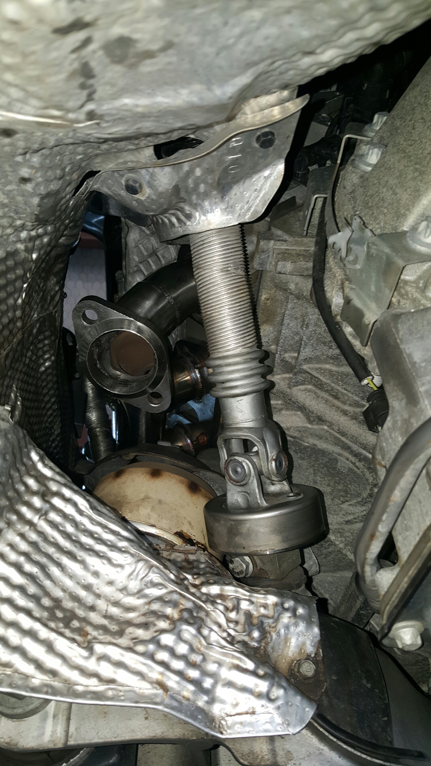

installed them today. Took a couple hours did it from underneath the car. Bolt right in no modification required.
I've only driven it a little. Still sounds the same. Def feel like it pulls better from 5-7k rpm

I did them from underneath, really didn't get a good picture
