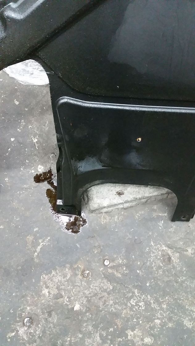

it's 30 degrees here so no way to get it to 80c . I tested it at cold and I barley got a reading on the dip stick . I warmed up the car a bit and drove it but it's jersey when changing gears . I just checked with mercedes dealer and they said usually around 4 but 4 clearly isn't enough . Since I had a leak due to the connector plug do you think I maybe lost more fluids than 4 qt ? It was pretty wet on the bottom of the car . The picture is of the plastic covering the transmissions . There was oil also om the exhaust

If it's been leaking a while, then yes, you can lose a good bit.
