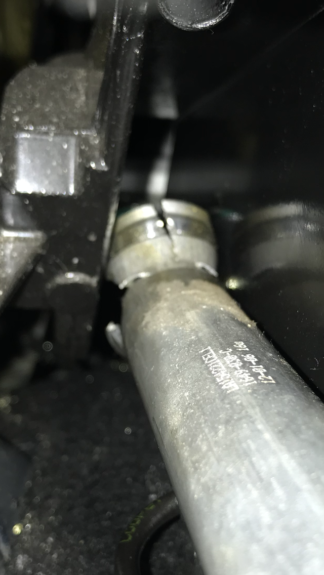

My instrument cluster was replaced. When I wanted to open soft top. No go and a puddle of oil. Did a check and found Right main lift cylinder broken. ( I have attached a picture). Question I have, is this related or just bad luck? I am confident to do replacement myself, but concerned if maybe there is another issue, potentially after cluster change.
R main soft top cylinder.

Not related. Frankly, I'm a bit curious why you would think it might be.

Only reason I suspected was the timing of the cylinder failure. It failed first time after the cluster was replaced.
Is there anything else I should check or just replace the cylinder.

Just replace the cylinder. Check with Klaus at Top Hydraulics. He won't be able to fix yours, but he may have some rebuilt spares available.
