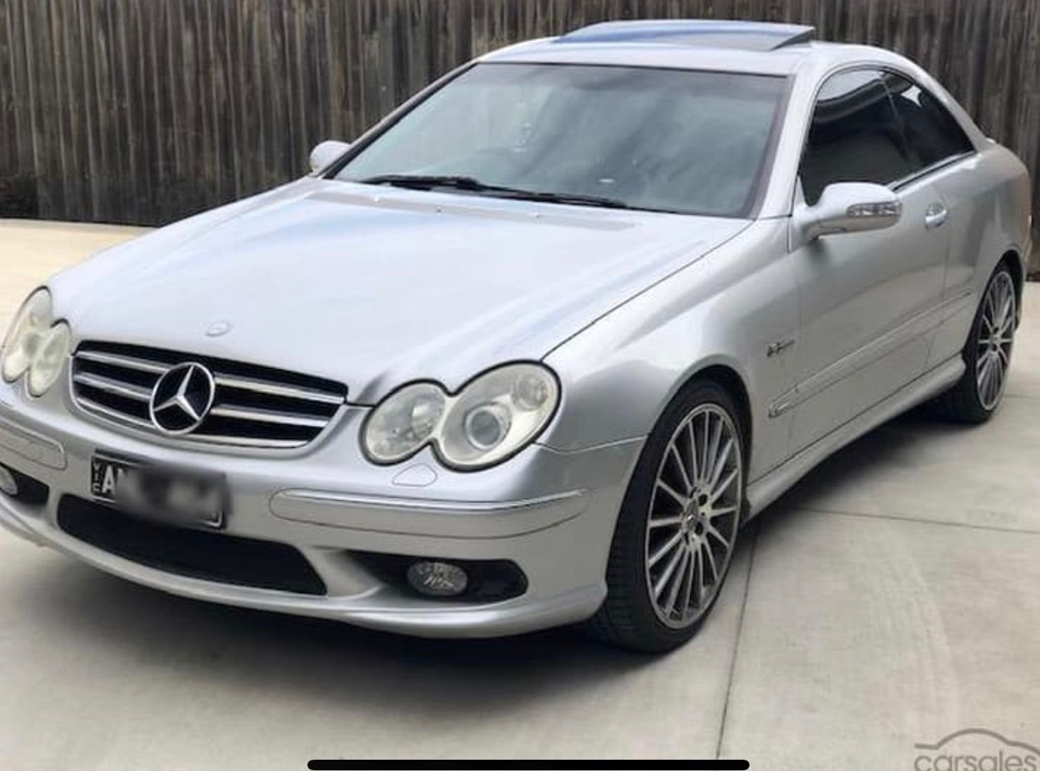

Hi Fatz, thanks for your reply. From what I understand, I have seen other CLKs, particularly 55s and 63s with 19" wheels with quite wide rubber. Here is a picture for reference as to what I'm talking about. These wheels are also the same ones in question in my OP. I think if I am on stock suspension, I should be able to clear them, but I'll see what the wheel shop says also.
