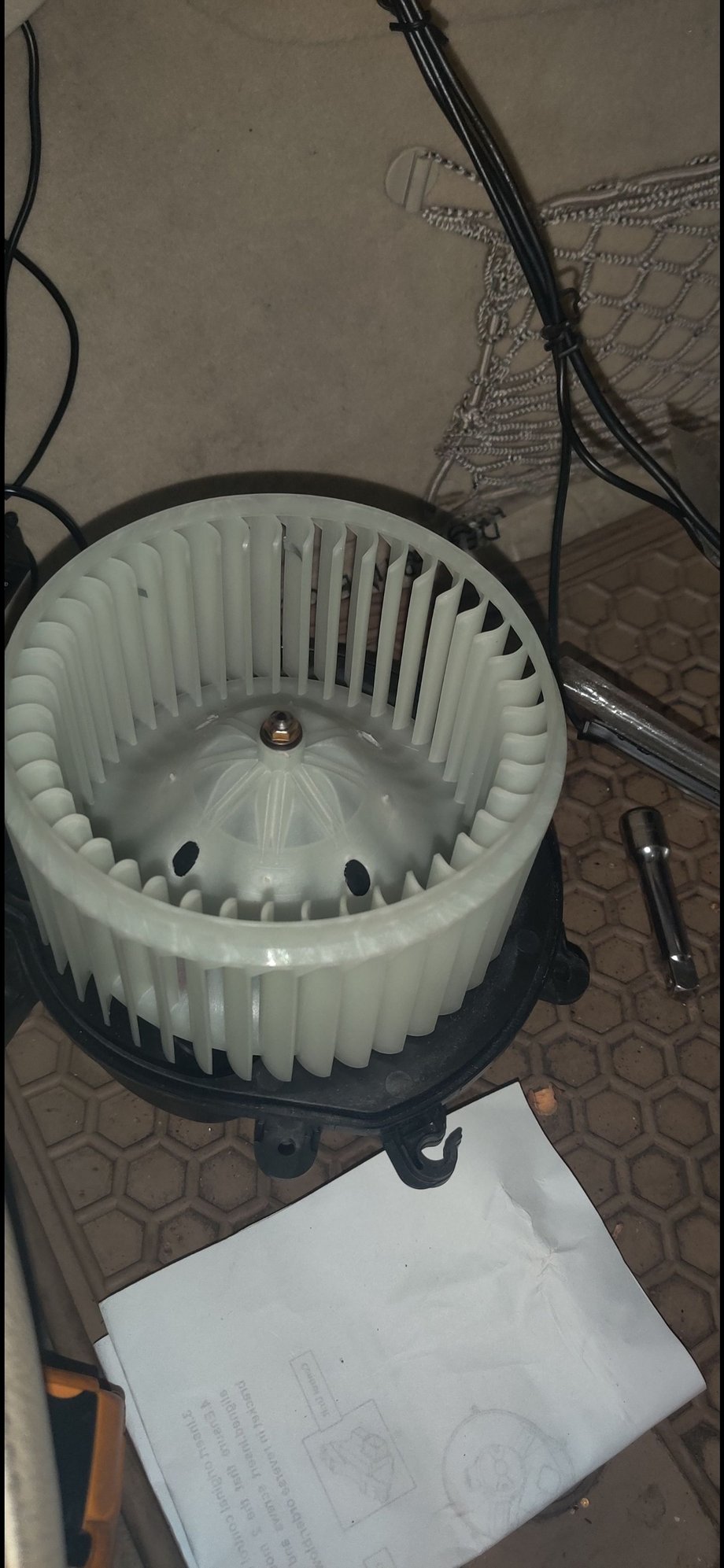

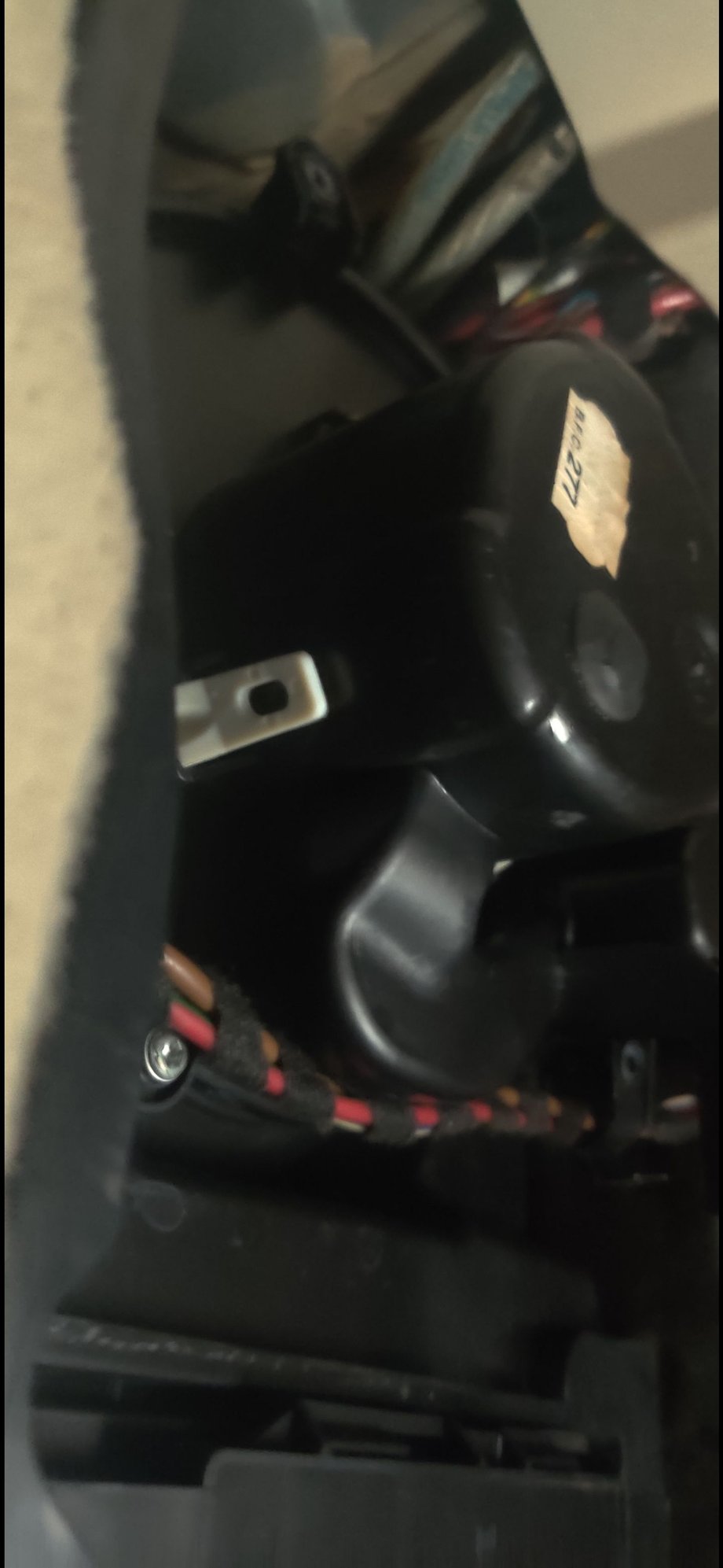

I would go underneath, where the fan is. Easy to access, there's 2 screws holding the plastic cover
Just take those out & pull the cover down and forward. Don't tug too hard I think it's a bit easy to rip. Then you'll have access to the fan, and that area of the car. Guess you can shake around a bit & see if anything is loose
There's 5 torx screws that secure the fan. I just did this job last month, it's not difficult but the position you have to contort your body is lol ahaha. I was definitely twisted & uncomfortable
Posted some pics for you
