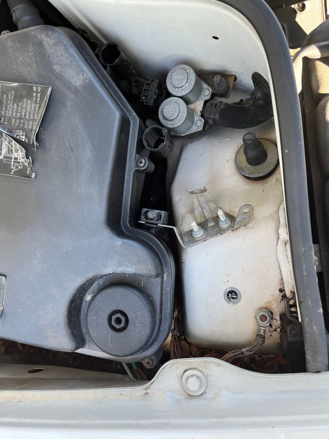

I did try locking myself into the car by sitting in the driver's seat and pressing the lock button on my FOB. I'm assuming there's also an IR detector under the mirror since locking seemed to work with the fob under the rear view mirror. So with me in the car and the door's locked via the fob I tried opening the door with the interior handle and no alarm, nothing, no sound or flashing blinkers. Could that be a hint that the alarm system is toast? Is the RF coupled with or part of the alarm system?
Is this where the siren/speaker is supposed to be located? Note the nice empty bracket...?
So many questions.
Thanks!
