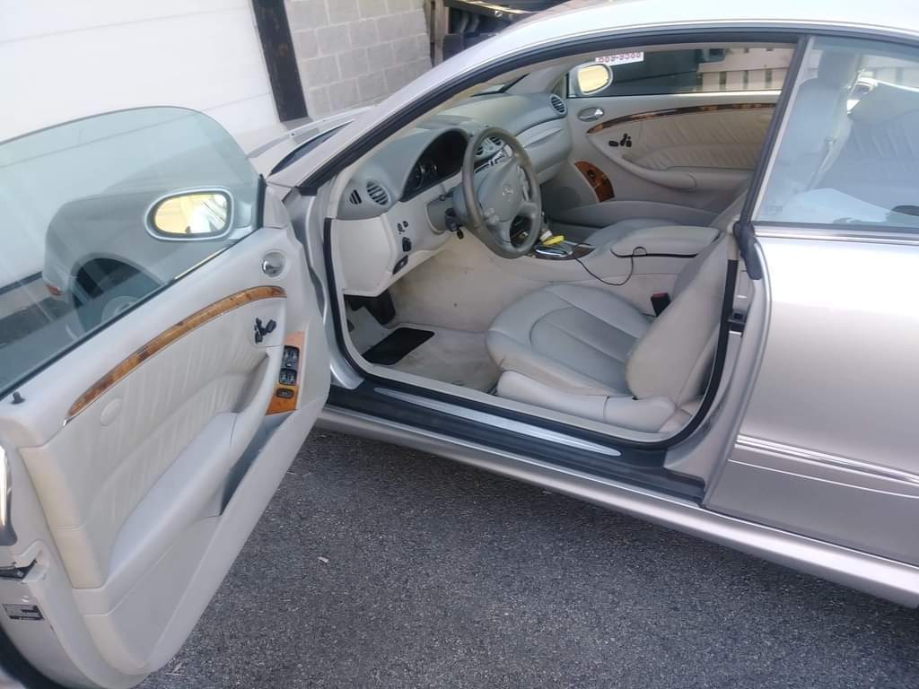

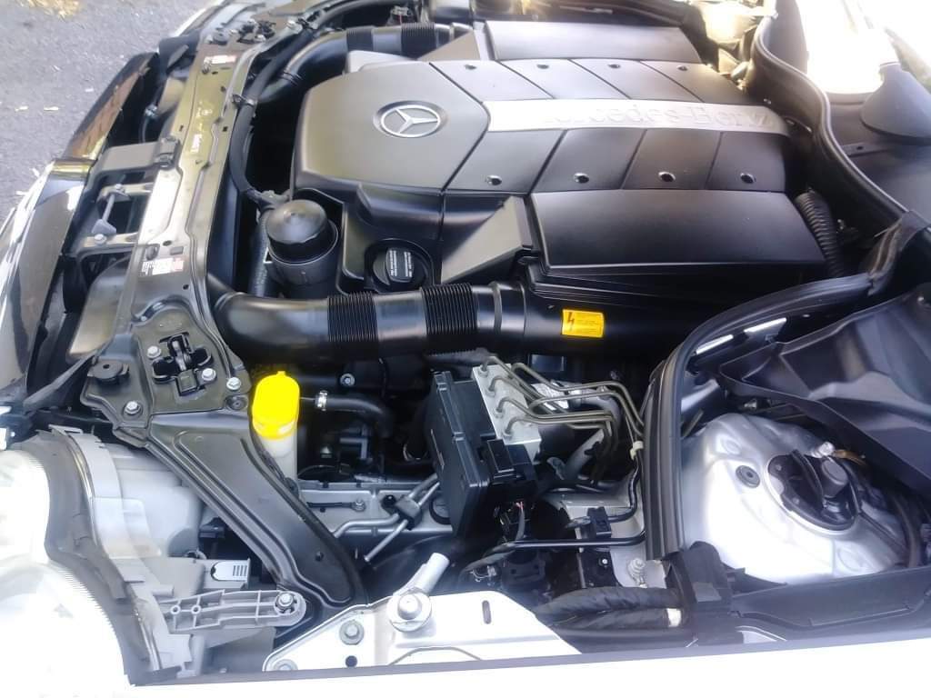

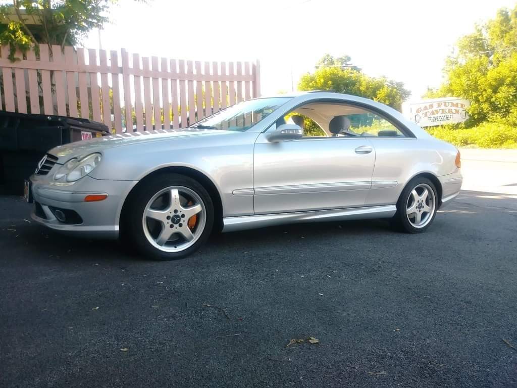

Hey all, completely new to the MB world. I have a chance to get a 2004 CLK500 that I am super interested in. At 170,xxx miles it looks like it has been very well maintained as far as my standards are concerned. I can't find much info on how long clk's are expected to last or what problems might arise at such high mileage. I don't want to jump into a car that's going to die in 20k miles. Any advice / tips on what to look for would be appreciated! I apologize in advance if there is already a thread for this, I don't do this kind of thing very often.

The M113 engine is one of the best manufactured by Mercedes. The 722.6 transmission is a very reliable 5-speed so long as you perform periodic fluid replacements. By 200,000 miles expect to replace valve cover gaskets (to include resealing the oil separation chambers) and the rubber o-ring located between the oil filter housing and the engine block (you'll know if it is bad because, when you get under the car to change the motor oil, you'll look at the driver's side front of the engine from underneath and say, "Where the hell did all this oil come from!".)
Maintenance records are the key; if the car has been meticulously maintained, you will get a good classic car that will be reliable. When you get a pre-purchase inspection, ensure the MB mechanic checks the transmission values; that will tell you of the status of the solenoids plus the clutch and brake packs. 1 each 20ms pulse is for a new pack, 15 each 20ms pulses indicate the friction discs are completely worn. Anywhere between is okay.
First thing to do is to purchase a *quality* diagnostic system. I have a C3 and a C4 system and they have been worth every penny I spent on them (~$1000 each). There are some less expensive aftermarket ones out there available for less than half those costs; search the forum and you will find multiple posts on it.
FWIW, my '99 W210 E55 (purchased January 2014 for $7000) has ~170,000 miles and my daily driver '05 W211 E55 (purchased August 2014 for $20,000) has >225,000 miles. I would estimate I've spent the purchase price of each one on replacement parts and maintenance on each since purchased (especially the W211. Damn, that is one expensive car to maintain!).
