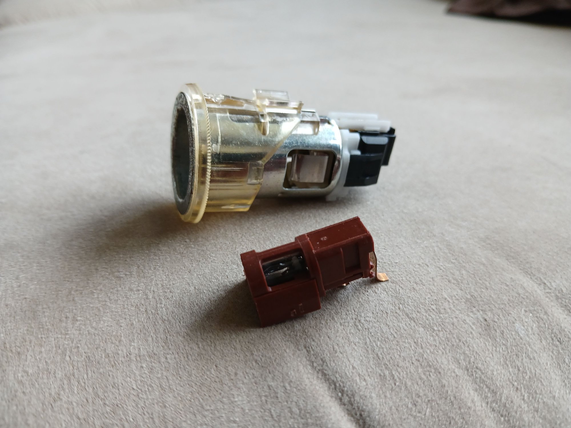

Lighter removal
Is this the red block you are referring to?
If so it is just a housing for a small light bulb. It snaps off fairly easily.
