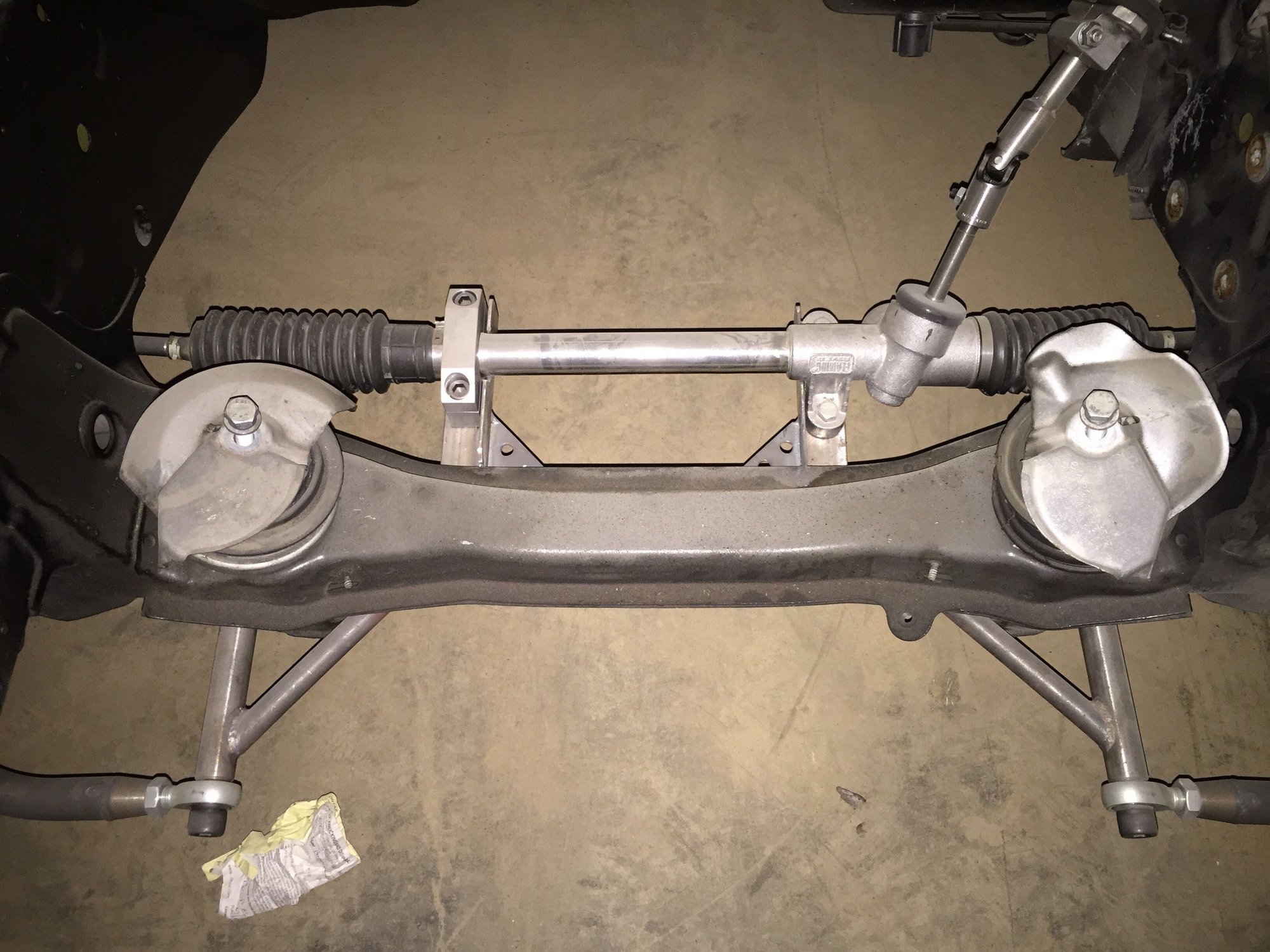

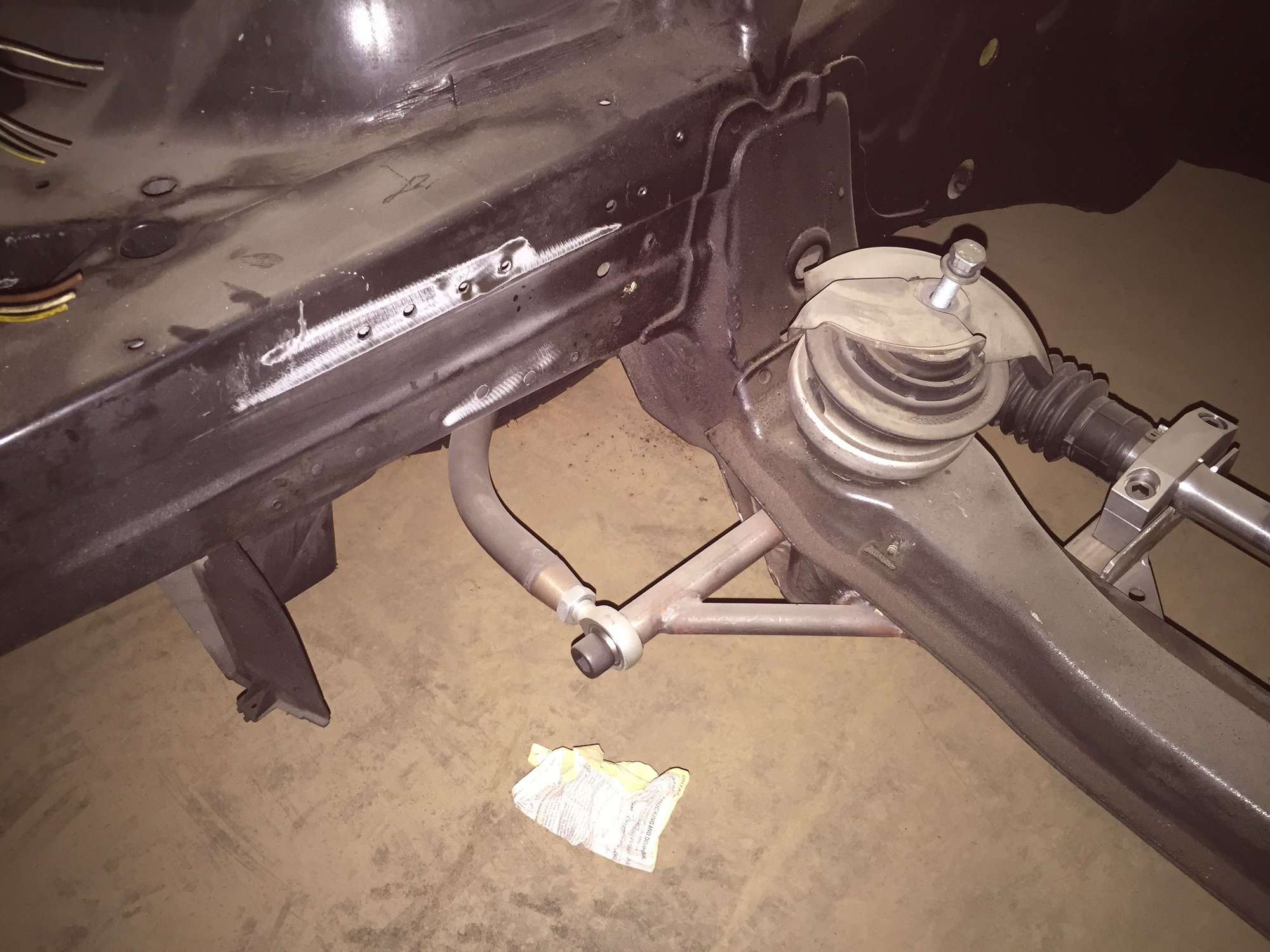

Yea I finished the conversion, but more to it then meets the eye. I had to use a reverse steer rack and it's a manual rack. Mounted a GT front strut and made lower control arms. I'll take pics of the actual rack and parts under hood. But i selling this conversion set up . Anyone interested let me know. I'm doing another front setup .

Old Jul 4, 2016 | 10:35 PM
  #44
2PRECISE's Avatar
Joined: Jul 2005
Posts: 346
Likes: 13
clk55 amg
More pics
Did some work on the car tonight and took some quick pics of the rack
Old Jul 4, 2016 | 11:46 PM
  #45
GatorMB's Avatar
Joined: Oct 2012
Posts: 1,427
Likes: 100
From: Florida
2002 CLK 55 AMG cabriolet Eurocharged
Vunderbar,
That torsion arm is looping me. Is that a countersteer device or sway/torsion arm for the suspension. hmmm!!
Cheers
With all of the frame indexing going on here, It is looking like a track car.
Last edited by GatorMB; Jul 4, 2016 at 11:49 PM. Reason: added content, happy 4th folks
Old Jul 5, 2016 | 12:43 AM
  #46
2PRECISE's Avatar
Joined: Jul 2005
Posts: 346
Likes: 13
clk55 amg
you're probably looking at the other side of the lower control arm.
