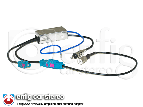

I have a 2004 CLK55 AMG Convertable and just had a Pioneer 4400 installed at a local shop. They can not get the factory antenna to bring in a clear signal from fm / am. I checked around on the forums and found some help and ordered an antenna adapter the includes a plug for both the steroe antenna and the weather antenna (AAA-VWAUD2). I hooked it up and still static? I want to keep the factory antenna, any suggestions?
I also thought the stereo shop cut a wire that powers the factory antenna but dont where or what to look for?

The factory antenna's have not been the greatest design. I would try and source out a new antenna before proceeding with any sort of after market equipment. If the car is still at the "local shop" stop by and have a listen yourself. The shop may be used to having crystal clear reception.
