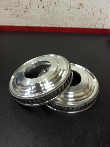

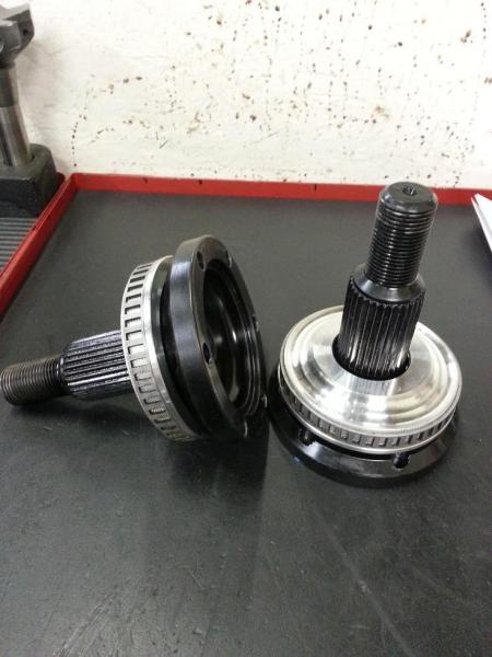

Took a little longer then expected, but its finally complete... 215mm diff with 3.55 gear and huge DSS axles. Kit is completely bolt in with 0 modifications to car. Testing at dyno and track hopefully this week. Worlds fastest benz title he we come!!!
ABS rings...
Attached Thumbnails 215 Diff Conversion KIT-abs1.jpg   215 Diff Conversion KIT-abs2.jpg   215 Diff Conversion KIT-abs3.jpg

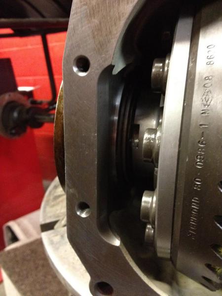

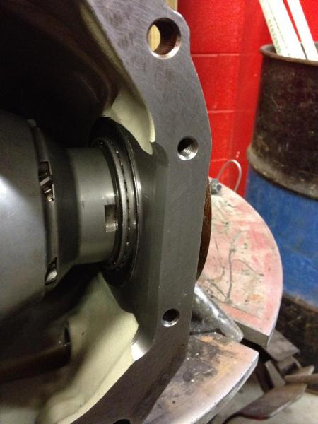

housing machined to fit heavy duty quaife...

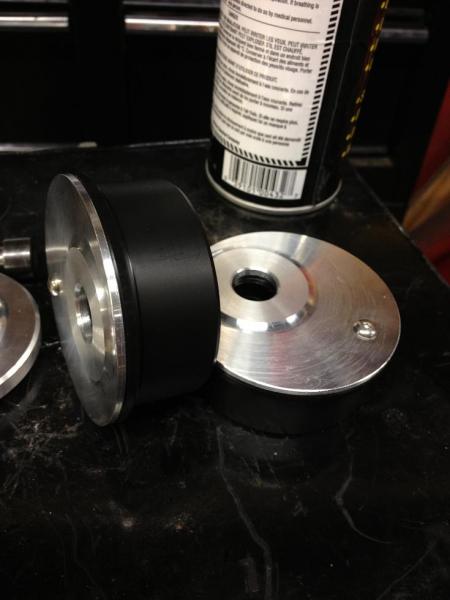

Old 09-23-2012, 01:55 PM
2PRECISE's Avatar
Join Date: Jul 2005
Posts: 346
Received 13 Likes on 11 Posts
clk55 amg

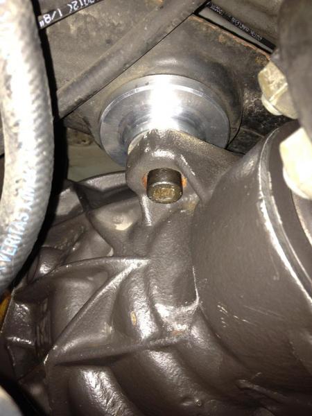

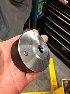

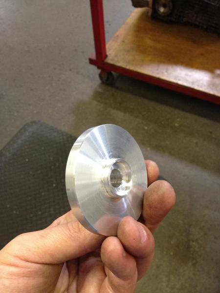

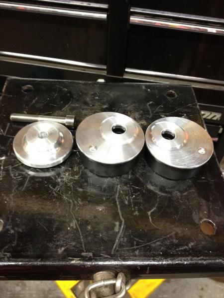

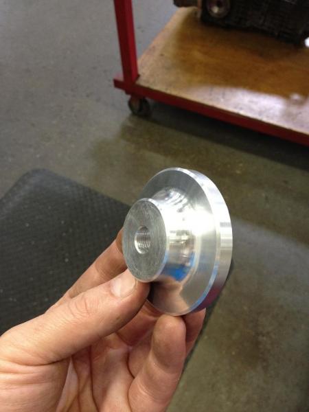

mounts......
Attached Thumbnails 215 Diff Conversion KIT-img_1417.jpg   215 Diff Conversion KIT-img_1418.jpg   215 Diff Conversion KIT-img_1420.jpg   215 Diff Conversion KIT-img_1421.jpg   215 Diff Conversion KIT-img_1422.jpg

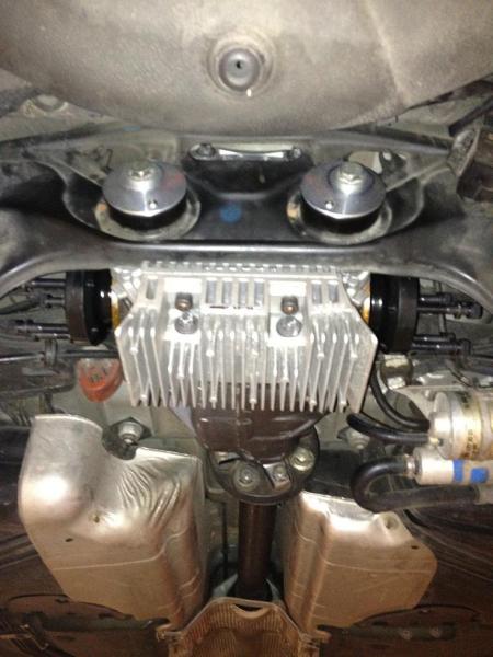

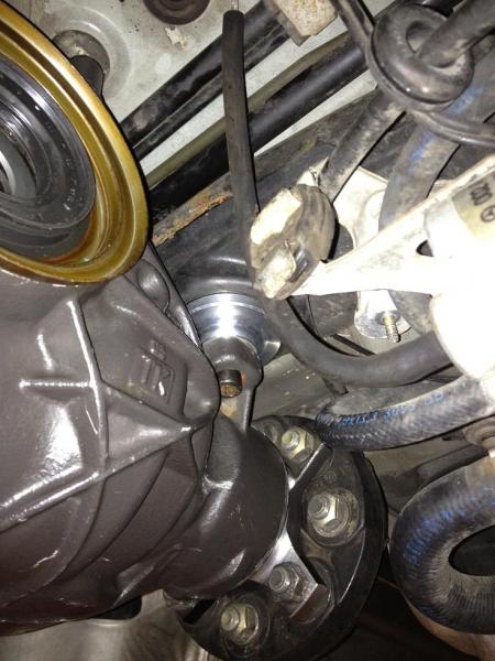

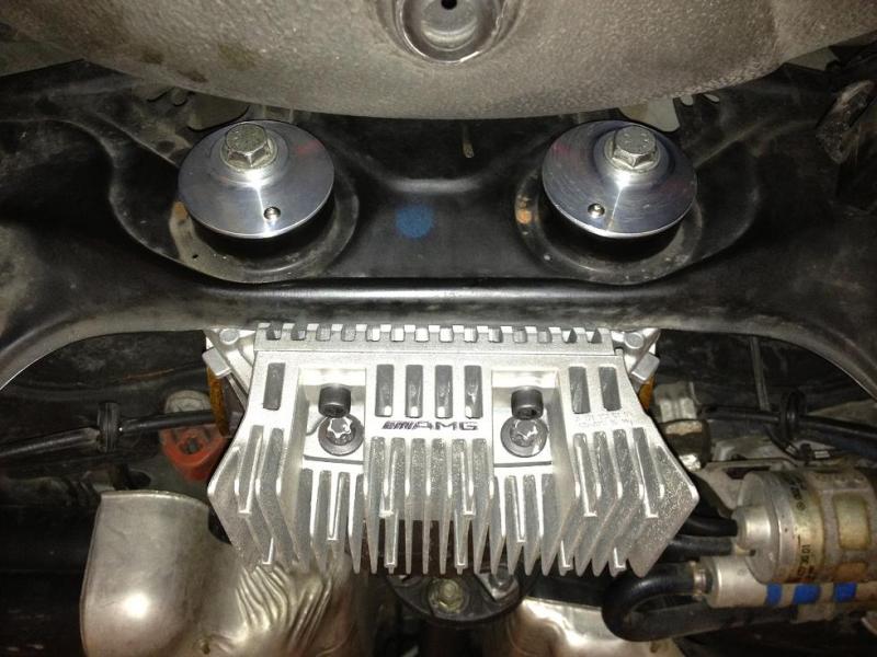

diff installed....
Attached Thumbnails 215 Diff Conversion KIT-img_1429.jpg   215 Diff Conversion KIT-img_1430.jpg   215 Diff Conversion KIT-img_1431.jpg   215 Diff Conversion KIT-img_1434.jpg   215 Diff Conversion KIT-img_1489.jpg

Good to see this coming together. The tone rings are strange though. Are you going to have modified wheel flanges with a larger spline or stock splines?
I just finally got my subframe and started looking at dropping the 215mm in my car. I have the DSS flange for the differential. Man that thing sticks out far. I was thinking of doing offset bushings like you did and then started contemplating just cutting out the back of the subframe and welding in a new plate for the rear mounts. Not to worried about duplicating it.

Yes I got the gears from richmond. Beware.... there is no shim kit and installing the gear was a ***** cause i had to machine all new shims. And richmond gears are noisy.
The axles flanges and hubs are all from DSS. I redrilled and splined the wheel hubs to 33 spline and the diff flanges are stock spline( alot bigger then the 210 diff).
A have the PCS TCU for at least 3 years now, just never bothered hooking it up... your gonna need a manual shifter for it, unless they came up with something currently. I just let eurocharged do it for now.
converting the 2 differentials is a little more difficult then bolting it up.. the mounting locations are different in 3 ways. When i did it, i dimensioned the 210 exactly and then made mounts.
Other then that, I went to the track already and went 10.4 hooking 1.6 and had zero issues.
