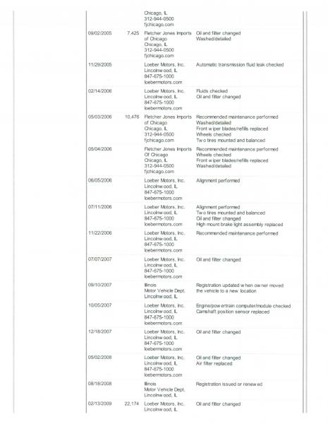

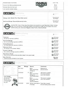

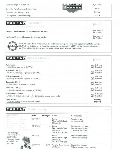

My friend(original owner) is selling his 2004 CLK55 AMG with 34K miles. It was very well maintained as you can see in the Carfax report. The camshaft position sensor and transmission were replaced(kind of weird for such a low miles car NO?).

- Ask your friend why the transmission was changed. Likely causes would have been a spurious TC failure that took out the oil pump. A lazy dealer that did not want to change a faulty conductor plate or a broken solenoid spring on the valve body. If it has a new transmission you should have nothing to worry about. I've known 722.6 transmissions do 1 million Km's if serviced every 39K miles or 60K Kms.
