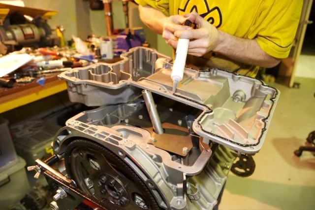

Looking at the photo of an oil pan you will notice the dipstick pipe is in fact at the rear of the engine in the larger compartment. The front compartment accommodates the oil pump, and probably holds a liter or so of oil. The drain plugs are both right at the bottom of the oil pan, and l am sure 99% of the old oil will be drained if both plugs are removed.

I agree with mrwhattie. You need to drain from both the front and rear drain plugs. The front reservoir holds at least a quart of oil. Using a vacuum extractor will never pull all the old oil out of the M113 pan.
